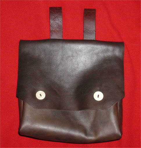

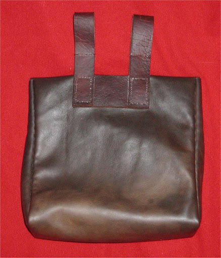

I had some of the 1.2mm leather left over from the snapsack I made recently so yesterday and today I knocked up a belt pouch to go on a 2" belt.

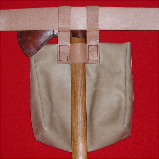

I had some scraps of thicker stuff laying about so I used that for the straps and the 2 bits between that holds the 'hawk. Since I had five layers to go through I drilled through with a tiny bitt in the Dremel rather than use a awl and it worked very well.
I will oil the leather now and leave it to cure like I did with the snapsack

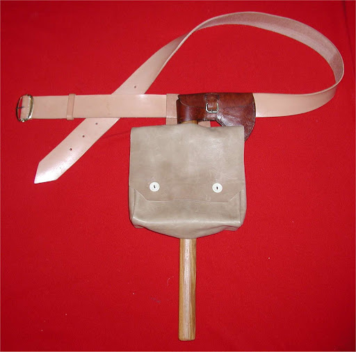

Thanks! The pouch is mainly to hold a small first aid kit, file or stone, a snack and be somewhere to stuff gloves and hat as the leather was a bit thin to hold bulky / heavy kit without me doubling it up or lining it with linen like the snapsack.
Also with my having a circumferance rather than a waist I don't think the belt would stay up if I carried much more than a 'hawk and belt knife there.

The saddle stitching with linen thread, two hole bone buttons and method of construction (stitching the seams while the piece is inside out) are all documened, the only conjectual bit really is the method of carrying the hawk. They are shown in paintings/illustrations as poking out from behind pouches but theres no indication if they were secured in anyway.
Oh and the cover for the hawks head is just my own design, the only contempory coverings I've seen seem to be simply drawstring bags pulled over the front part of the head or what look like rags or scraps of leather tied round them.

Cheers! after walking about with, it hasn't tangled with my legs yet, the one advantage of having a waist substantially bigger than my hips!
One cock up, the little Crocodile/Martingdales sharpening file I want to keep in it is nearly a inch longer than the pouch is wide.
http://www.ralphmartindale.co.uk/ralphmartindale/gen-sharp.html
No biggy but I am thinking of sewing a long thin pocket on the back to take it.
On that note I'm intending to pin scales to the handle of the file to make it more comfortable (and tarty) Assuming that part hasn't been hardened to the umpth degree and my drills bounce off!
