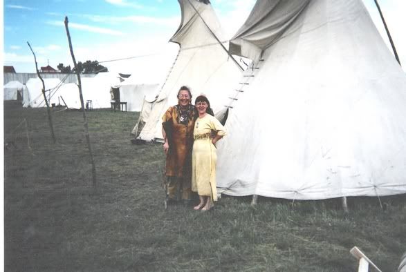

I have a traditional tipi, 17 poles, most of them 24' long its nice but not nearly as practical as the modern one,
the taller lady has the further tipi and the short one is my wife in front of ours
