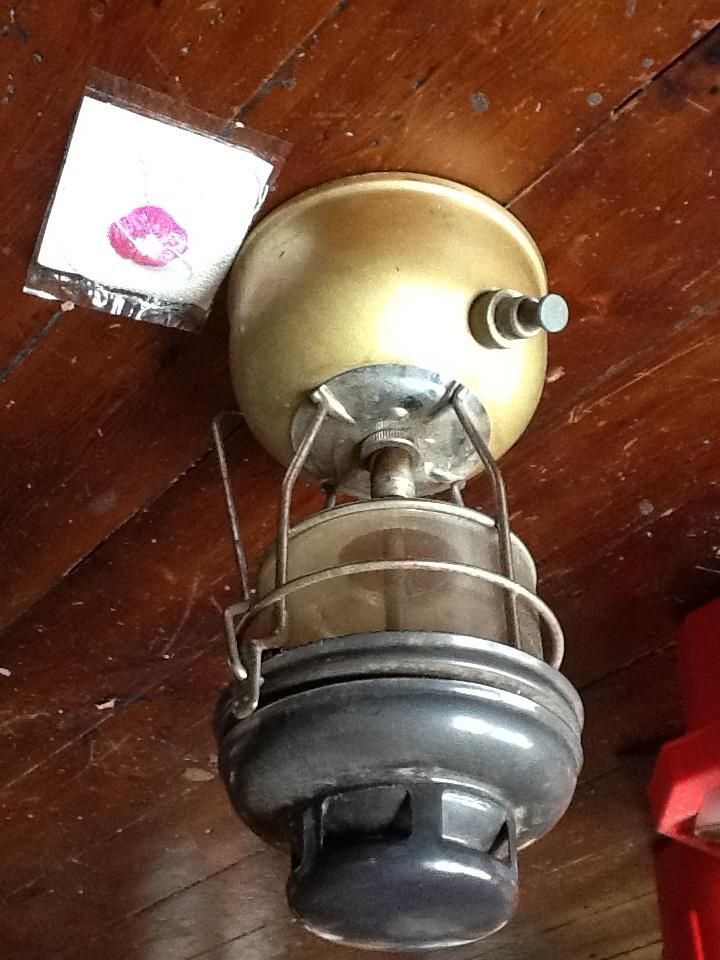

Poking about the charity shops and low end antique places I picked this up for 15 quid as it looked in really good condition, just dirty.
They guy chucked in two mantles, not sure they at the right ones, the packet says Bullfinch No. 1617, but I have spare Tilley ones anyway as I already have a lantern.
i know not every ones a fan of Tilleys but I've had no trouble with my other one so far and would like to get this one running sweet. Since I don't know it's history I'd like to change the seals etc. does anyone know of a cheaper source of the spares packs than this lot?

Had a quiet day so cleaned up the lantern and checked the various washers and springs Much to my surprise they all seam sound, I still will get a set of spares, and another preheater.
Ill it a new mantle and give it a try tonight.
ATB and thanks again
Tom
I couldn't resist it so had a go outside just now. No pressure at first until I tightened the filer/pump up. Lit fine ( very chuffed at this point ) then I noticed a very slow drip from the on off knob. Switched off , waited, then released the pressure from the tank.
so I need to get the right washers and springs set.

After a bit more reading on the Internet I've managed to cure both Tilly's of the drip from the on/off/pricker knob. The rubber glands/ washers were fine but I needed to tighten the knurled cover over them with a pair of pliers, as tight as they would go and still be able to turn the knob. So I just need to get normal spares packs now. I was rather chuffed with all three hissing away on the back yard as it went dark.

Re your "drip", the knurled knob isn't really supposed to be tightened with a pliers - indeed, anything "knurled" is made that way so that you can grip it with fingers, not tools - there's a very small washer on the stem of the valve - very easy to replace and should be in your service-kit. One should do the job. The black valve knob should just pull off / push on, then you undo the cover and replace the seal.
Not too sure about the model designation - X1074? Loads of info on http://www.classicpressurelamps.com/forum/index.php? btw. Also a really good place to get help / advice. As to parts, I use Base Camp (as already suggested). Nice lamp for the price.
