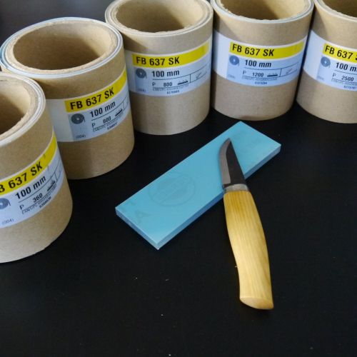

Wood board. Carpet underlay foam. Hermes adhesive backed sharpening film. Previously carried by Axminster, now discontinued. Try

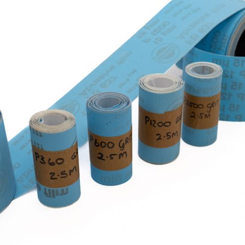

Thanks for the info. Went down the rabbit hole on his 1. Who doesn't love a bit of focused procrastination?) As an alternative to the hermes film rolls I found:
the 3M stuff is graded in microns rather than grit, but it's easy to google up a conversion chart

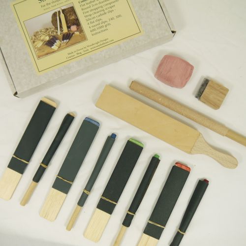

Also Woodsmith sell a similar sharping kit if you don't want to make one yourself:
and sell a slip & strop set including round slips/strops for sharpening curved blades:
The sets appear to be produced by a guy called Sean Hellman who also does wood working courses in Devon and has written a book called Sharp that appears to go though the principles of sharpening and then shows you how to sharpen a variety of knives and tools:
