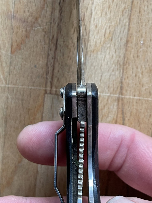

Plain edged, 8Cr13MoV steel, long leaf-shaped, drop-point blade with full-flat grind and no choil nor finger choil and full length liners, open-backed, Walker liner-lock, phosphor-bronze washers, black textured G10 scales with a lanyard hole. Jimping on the thumb-ramp.

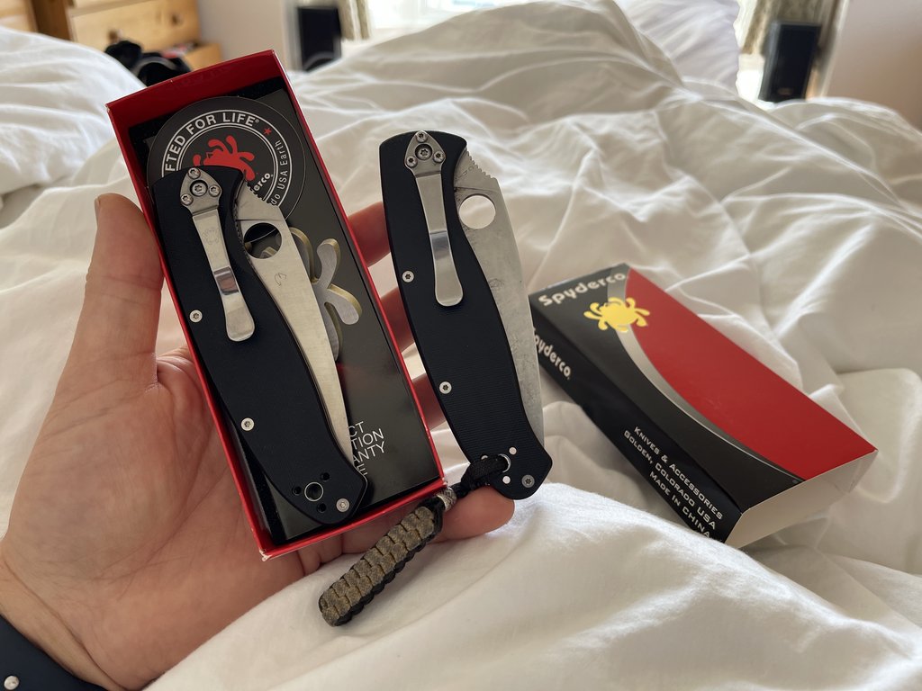

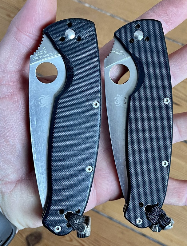

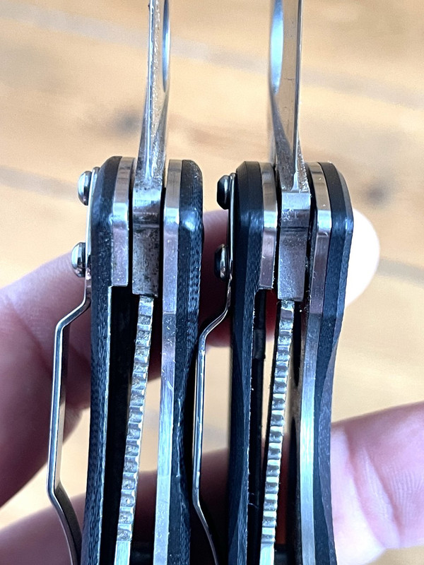

It's tempting to think of the Resilience as a budget Military, given the size and same lock type. The specs:
Resilience:
Military:
However, the blade on the Military is CPM-S30V and has a straight spine, as opposed to the gentle rounded profile of the Resilience, so a slightly pointer tip. The Mili also has a finger-choil and a bigger thumb ramp. The G10 scales are unlined, giving a slimmer handle and less weight.
The finger choil is a matter of personal preference, ostensibly offering good control of cutting close to the choil. However, the actual cutting edge of the Resilience extends right to the handle, negating this difference almost completely as there is almost no ricasso. This means that the Resilience actually has a bigger cutting edge relative to overall blade length.
Military blade length versus cutting edge:
Cutting edge length
The Resilience provides pocket clip 4 positions (I favour tip-down for long blades) versus the Military's one. Better for lefties, though Liner-lock don't necessarily suit left-handed use anyway.

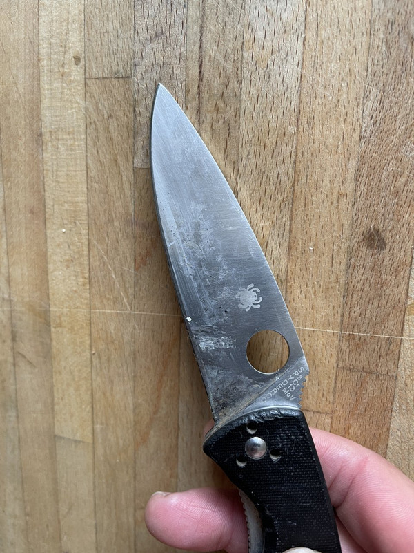

On paper, S30v chemistry should out perform lowly 8Cr13MoV but in real world use the latter is an excellent compromise of edge-holding and stability versus ease of sharpening.
I've been down the rabbit hole of hyper-steels, having used Farid CPMRex-121 fixed and folders, Phil Wilson K294, S110v etc. I've come to realise that for my purposes, steels like SF100, O1, Aus10a etc serve my needs as well, if not better, than their high-carbide cousins (I confess to a soft spot for CPM-3V, though). 8Cr13MoV is in the "basic" steels category.
It's plenty tough enough as I found when I dropped it point first onto a tiled-floor:
I live by the sea, enjoying kayak and spear fishing, but corrosion has not been a problem (rinsed thoroughly after use), though I carry a Salt blade for these activities most of the time. My usual Salt folder was confiscated by airport security (I'd left it clipped in my board shorts and was travelling with hand baggage only, oops!) so the Resilience filled-in until a replacement arrived.

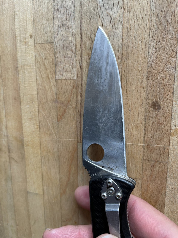

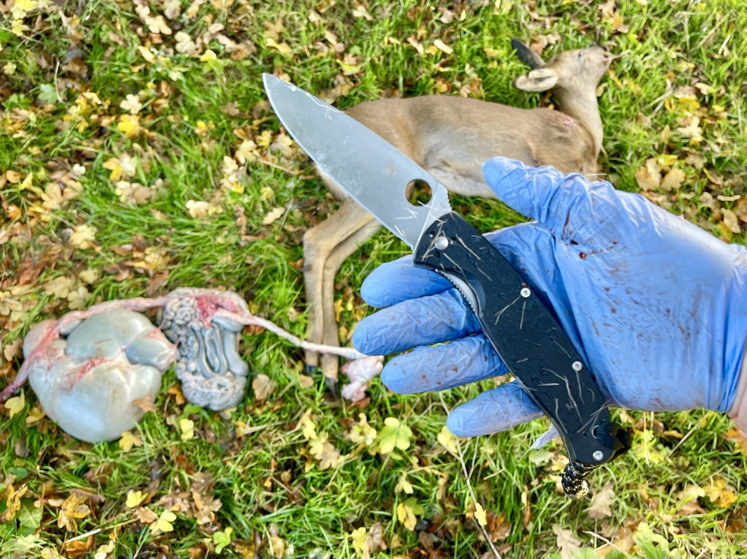

The hole is 12mm: useful for scale in photos:
Parasols
Amanita

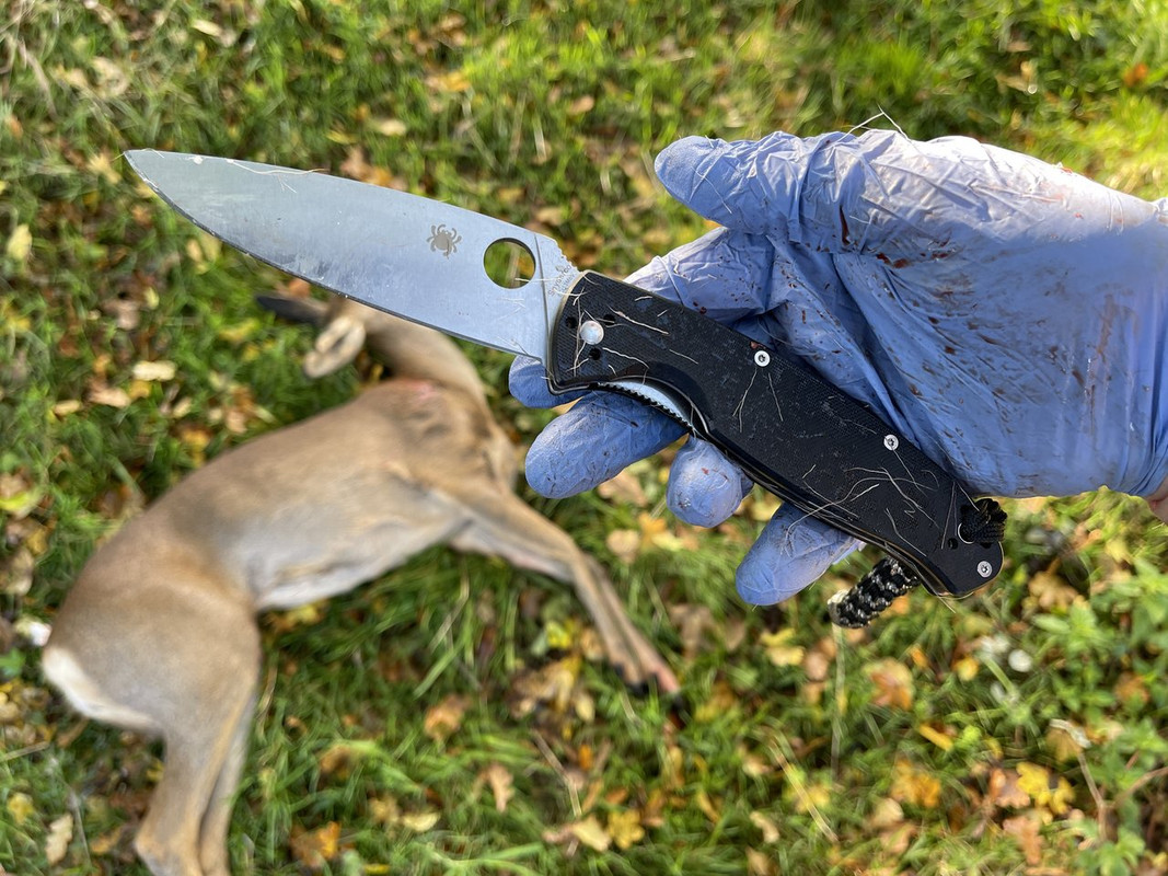

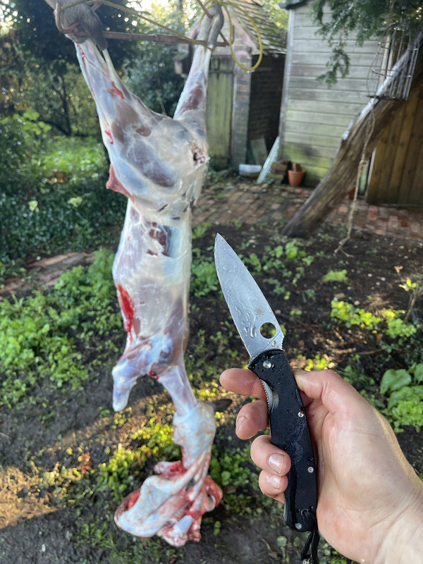

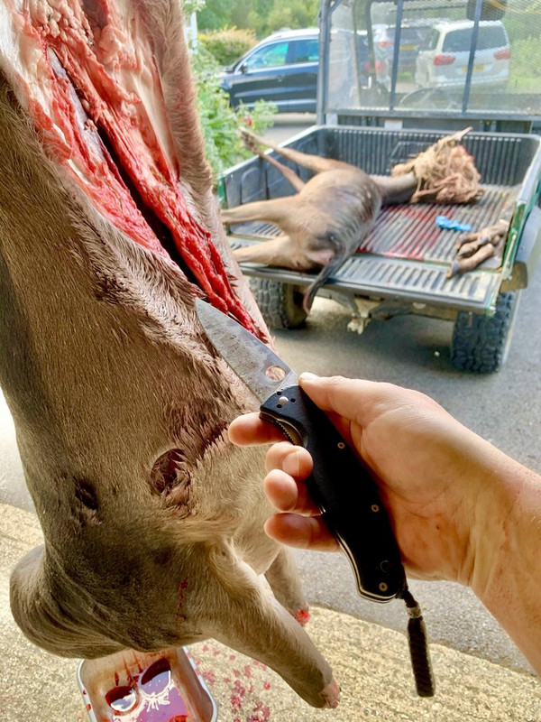

The full-flat grind and long blade mean this knife excels at food prep (not as good as a dedicated kitchen knife but better than most folders.)
