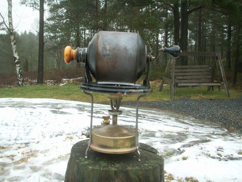

For anyone into boot sales, or thrift stores, there used to be a primus roasting attachment sold in days gone by. I've once seen one but didnät get it. Feel kinda sorry now, but someone else might get lucky. Looks like this:
