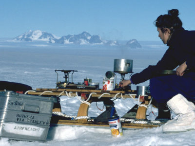

I'd guess reliability and relative compactness. Anything smaller is pretty well useless in deep cold.
My understanding [ albeit limited] is that the 45s were used inside choofer boxes made from empty square kerosine tins or nailed together plywood sheets to limit heat loss

Yet we Aussies and ANARE have gone to bottled Propane for ease of use and reliability when using motorised transport.
Maybe because replacement 45s and the ilk are now too expensive; fetching big dollars now since production stopped
