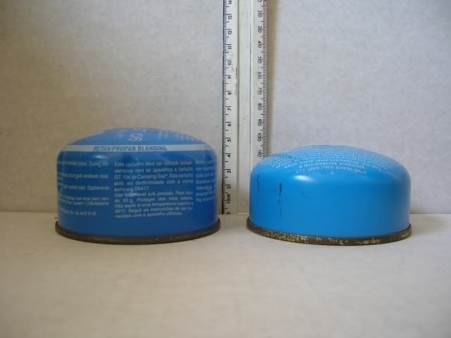

They look to fit the Camping Gaz Globetrotter stoves, We used to use them in scouts back in the late 90's till they got banned due to the nature of the system (puncture cylinder with no safety valve). The cylinder itself i think should have the number/model GT106
They will be GT 106's and they fit the excellent little Camping Gaz Globe Trotter stove and lantern. The canisters have long been out of production so the stoves are effectively obsolete unless you modify them with longer bails for the larger 190 g canisters....
It ain't necessarily so. They will be either the GT106s as Johnboy suggests, or the Bleuet cartidges that I guessed. Its hard to tell from the view that Tengu has given us as both cartridges are the same diameter. The sure way to tell is by the height; the Bleuet cartridge is 46mm tall whilst the GT106 is somewhat taller at 55mm
