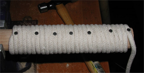

I'd picked up a can of Stockholm Tar and had some of the dirt cheap cotton sashcord/rope left over from another project.
I was too lazy to go up the garden to the wood pile so I used a couple of foot of broom handle left over from making one of the lads a shield.

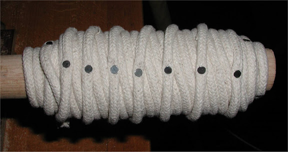

In the end I used 5 rows of tacks to hold it on (staples would have been a better) and ended up with this.

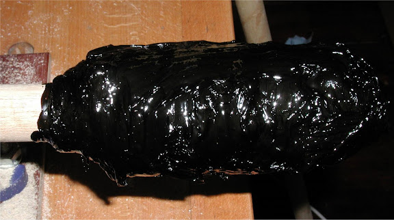

I then melted (outside with due care) 3 ounces or so of beeswax and stirred in the tar untill it was very runny and could be brushed onto the cord which soaked it up nicely. As it cooled I smeared the hardeniing goo on so not as to waste any.
The wax in theory should make the tar dry a bit better, and bulked it out.
I appreciate there is limited scope for its use and it will drip fire like bugg*ry so i will have to use it held at 45degrees and over a non flamable surface but it got it out of my system.
