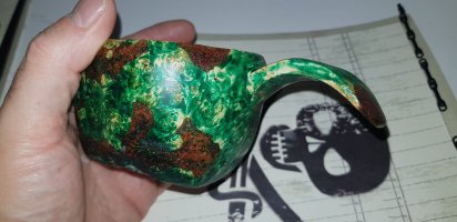

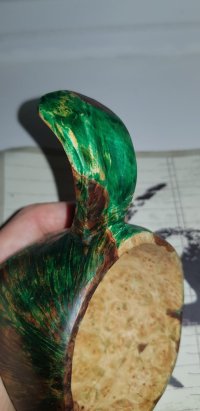

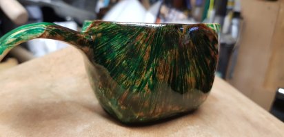

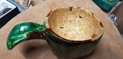

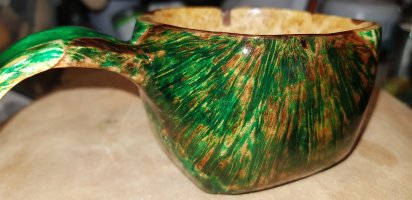

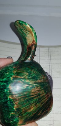

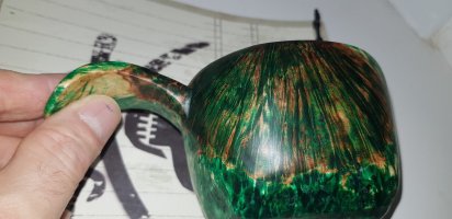

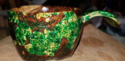

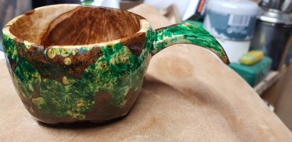

Hey all.
Made another gift for pal. This time, I tried a rather different finish on the outside. I saw some amazing kuksa's made by a chap that were otherworldly. I contacted him on the process involved and he kindly told me. This one is pretty much done apart from some more sanding. My first with this type of finish, using a small burl with not much room for maneuver.

Looks great! Is it a dye under a foodsafe varnish?
Aye. Green dye, the brown is the natural colour, along with the normal birch colour of the burl. Also food safe mineral oil on the inside. Outer edges also has fresh mineral oil on it, hence the glossy sheen. I'll likely add a number of more coats to that. Apparently, 'birch tree tru oil' is used on the outer edge by the pro's. Gun stock oil I gather. Giving a permanent seal and gloss. Not sure on its food safe qualities though, which is why I opted to use the mineral oil.
