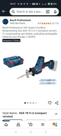

Just to add to the mix here, I had a lot of scrub to clear during COVID lock down.....as well as working.
My wife refused to let me use the chainsaw, so I bought a Bosch Blue Reciprocating saw, it was brilliant and still going strong...yes it's slower, but much safer and doesn't drain the batteries as much as a chainsaw would.
I cut through 200mm rounds quite often and doesn't hold up at all. The cut thickness is down to the blade used and if you can I would recommend the 9inch long carbide tip blades....they just keep going.
This is what I got as I wanted a one handed version
But in hindsight I should have bought the larger version for just that bit more grunt in torque.

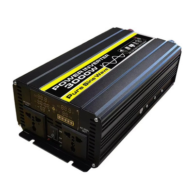

Seems a bit cheap. Either it's s bargain or it's too good to be true..... and I know which of those options my money is on.
Compare the price to a Durite or Victron inverter with the same rating and you will see what I mean.

yehi think naff. i keep hearing victron. not cheap ime guessing. i will llook. thanks x

what does anyone think of this invertor? xxxxx
Not a 3000W inverter, it's a poor quality item possibly capable of delivering its stated 600W continuous output until it goes pop. Sorry to be brutally honest!
