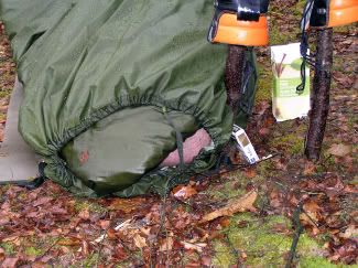

I was out in Feb like that in the pouring rain (see photo of the top of my head below) and again in April in the rain and although I was slightly damp from condensation I didn't get rain wet. Trick is to get in it with it face up and then roll right over taking it with you so that the large hood flap goes right over your head and then pull in the draw cord leaving just enough room to breath out of. The rest of my kit stays in my bergan with a drybag liner so that stays dry and my boots go upside down on stakes so they stay dry too...easy :)

Thanks a lot Bamboo!
I might make up a mini tarp to cover the head from an old goretex jacket. Perhaps 3 square feet attached to the bivvy bag with buttons.

Lol....I've been talking about doing the same thing of about the same size since last Feb! Was thinking of cutting a USMC poncho in half and then re-hemming it....haven't got round to it yet though :lmao: Also, I rather like waking up and looking straight up at the sky (unless it's raining obviously lol)

Lol...luckily that was the packet I finished the night before so it was empty....my fresh pack was safely in my bergan ;) I did wake up to hear the others asking if I was smoking inside the bivvi bag though as my breath was coming out like steam....well it was cold out and I was toasty lol (I wasn't smoking in there!!! :eek: ).
