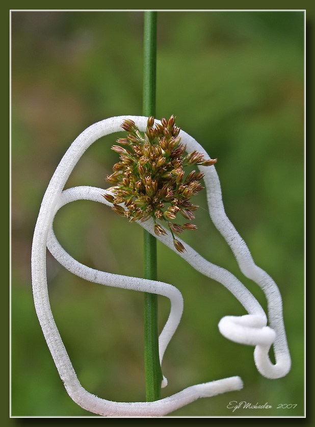

Some of the straws the Modern History guy collected looked like plain grass of some sort.
This is Juncus effusus wich was used as a wick in oil/cod liver oil lamps here.
And this is a pic of a straw and its marrow (the wick).
In the old days it was the childrens job to "peel" the straws getting the marrow out.
That said; while I`ve got short pieces of marrow extracted from a rush, I`ve never made lights nor used them as wicks in a lamp.

There are two kinds of rushes used best. One is as @Tor helge shows, the small field rush that is common across the UK. It's best pulled from close to the root, and instead of stripping all of the pith out, just peel off most of the outer, but leave a strong strip running up the length to help keep some structure to the rush light.
The second rush is the soft rush, the loch and lake rush, and it's pith can be over a cm thick. Peeled the same way, soaked through on a cresset, it burns very well, very much like a candle.
