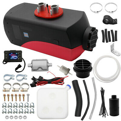

The Chinese diesel heaters do come with a separate fuel tank. This can be secured to either the outside or inside of the van depending on your requirements. I've seen them fitted wih the fuel tank underslung on a custom made bracket. Holes are then drilled through the floor of the van to install pumps, fuel and air lines. All very neat and tidy. I have an eberspacher diesel heater which has a fuel line directly into my vans fuel tank. That way I don't have to worry about filling two tanks, or running out of fuel for the heater (which will invariably happen right when you need it most, in the dark of night, in the wettest coldest conditions!).
One thing to consider with a separate fuel tank is the assumption that you will carry spare fuel for it. Where will this spare fuel be stored? If the fuel tank for the heater is internal, are you comfortable with 5 or 10 litres in the tank plus however many litres spare sloshing about inside your van while you're driving? Are you having it professionally installed?

This is the kit. Rigid fuel line, tank, heater, connectors, inlets and outlet ducts, fuel pump, controller, filters, exhaust muffler, mountings. Very simple, it’s a mini diesel engine that draws air in from outside, and pumps exhaust gas outside (that’s the two holes in the pic, the heater is upside down).
The clever bit is a fan that blows air from inside the van over the hot engine and pumps good dry heat is completely separated from the the combustion chamber. It’s just an air cooled diesel engine where the warmth is circulated into the van. Your leisure battery will be running the fan and the glow plug to vaporise the diesel fuel. That’s another good reason to be using the separate fuel tank, the system isn’t affected by a flat vehicle battery.

It could be argued the other way, totally depleting the vehicle fuel tank would leave you in a worse situation with no heat from the diesel heater or able to run the engine. I’m fine with fitting either the 5ltr or 10ltr tank secured in the vehicle, I’ve carried many cans of two stroke mix and spare petrol over the years in arboriculture, it’s not dangerous at all. It’s a see though plastic so I’ll know when I need a fill. Diesel isn’t volatile like petrol, my main concern is dripping the tiniest amount will stink the van out, so I’ll be pouring carefully with a cloth, or getting a non-drip self seal nozzle like on the chainsaw combi cans. No way I’m dropping out my vans diesel tank to drill a hole in the top, and splitting off the fuel line isn’t happening either.

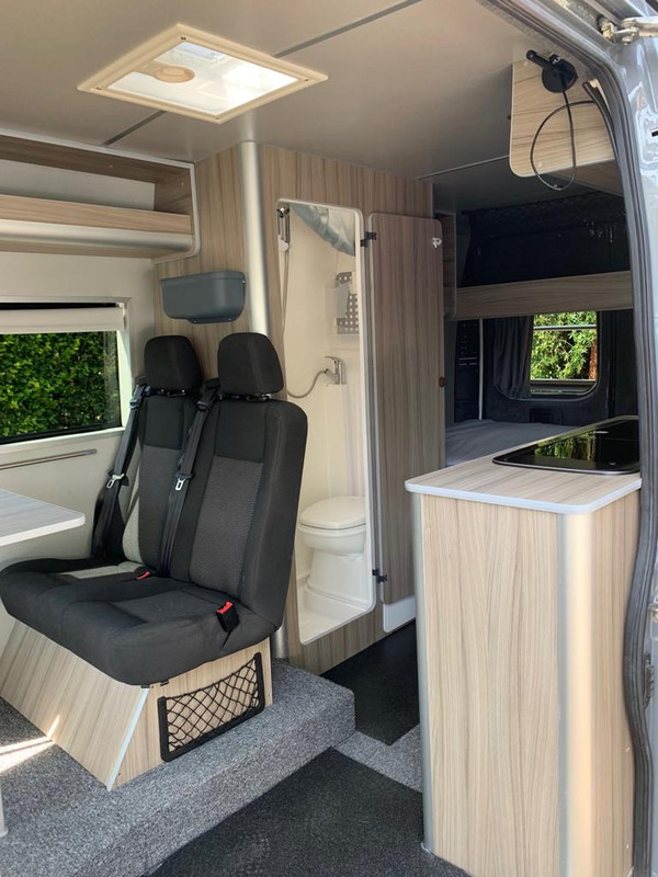

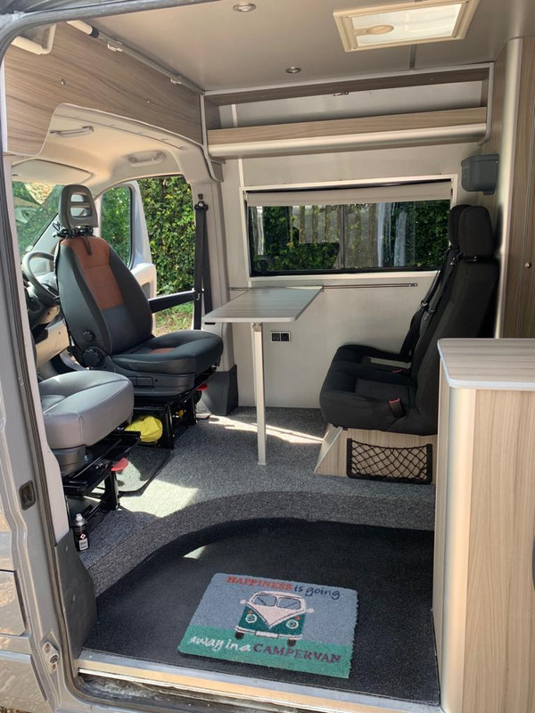

I fitted a 2kw Webasto airtop over the Christmas break and took the van down to Exmoor last weekend for a test. I think it's one of the best features of the van after trying it over a cold damp weekend. I plumbed the heater into a fuel line in the engine bay (rear engine camper) rather than drilling the tank. Running flat out it drinks 0.25 litres per hour but in reality it's on a rheostat so it's not on all the time.
Reactions: SaraR and Nice65
Agreed, it really is one one the best things you can do in a van. We were trying to demist and keep warm using the engine and fan. No chance, it hardly even gets warm on tickover, and I can’t run it all night anyway. My car has been in having some work done so I’ve been using the van, I’ve kept the heater on the thermostat all day. Got a battery for the remote this morning, so things are just about to get ridiculously lazy and cozy :D

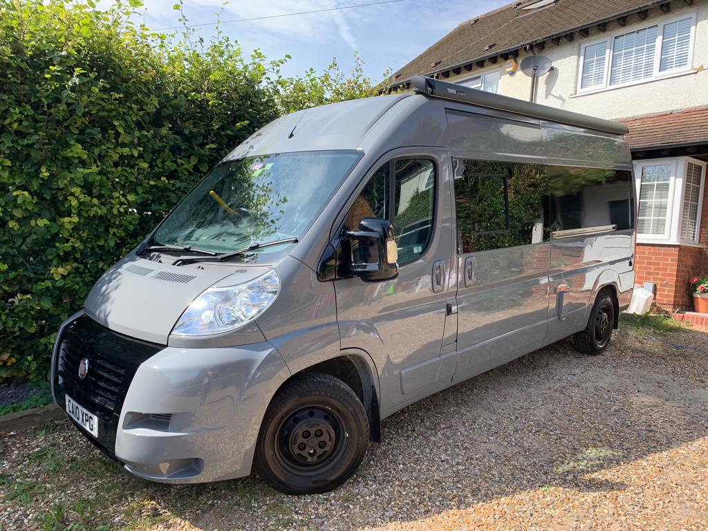

That looks a absolute cracker Rich, I'd love to see more photos of it.
I was smitten mate. I wouldn’t have known where to start with a black Ducato LWB ex-freight van. The guy who converted it bought it to tow his Audi to Le Mans, hence the Audi grey respray. Mileage is high on it and the sliding door needs to come off and be re-hung, clutch has had to be replaced already, but it’s a cool van. The pics here are from the seller, they’re better than mine.
