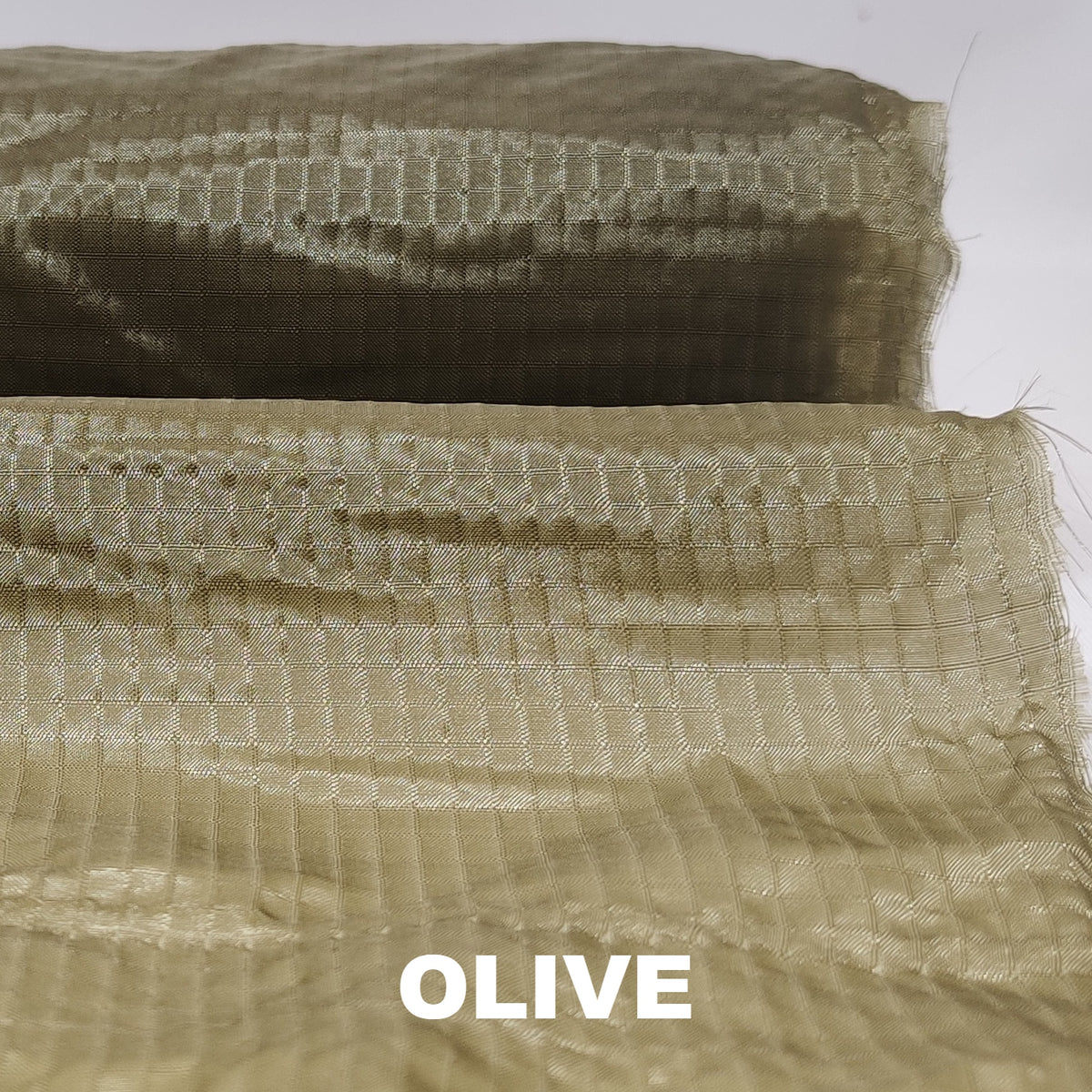

The material is genuine MOD, but it is advertised as..
'This is a factory clearance fabric and whilst it is new there may be slight imperfections in the weave which means this fabric is not ideal for parachute manufacture and should not be attempted'

I have used this stuff and something similar from Extremtextil (the latter wasn't calendered)
If this is the stuff you have, it is hardly worth making a tarp from it. What I have was calendered, so might be down proof, but not all ripstop like this is. If one side is shiny and one is matt, that is a sign it has been through the heated rollers involved in calendering. It makes it a lot less breathable, but is not waterproof.
Seam sealing will be pointless, even if you Nikwax the material, it will not be waterproof enough that the seams are the week point.
It will fray like crazy over time, so when you make your carry pouches, be sure to turn all seams, in fact, you might want to do an extra fold because the fabric can have a tendency to pull open at the stiches and if your rolled seam is a bit small you can end up with it pulling apart anyway.
