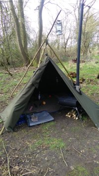

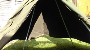

All the Polish Laavus are designed to be two man shelters, in reality they are bloody uncomfortable used that way. With the extension panel you get an extra 1.5 m between the poncho halves, which makes even the size one a more comfortable two man tent. Another tip to gain more usable space , is to ditch the centre poles and use a bipod to support the tent.
I would say a size three is best for size, but they are getting asrare as hens teeth and very expensive.
A photo of my setup using one poncho and the extension panel. There is even a campbed in there.
Thanks so much. Your set up looks sorted:) what's a bi pod? Is that when there can be a line supporting the roof by lifting top of tent suspended right out and tied to trees if you no what I mean ?I think I would agree with you there too on the extension panel,thanks. What do you use for a ground sheet? I noticed they are available but same price almost as the ponchos?

A bipod uses two poles a tripod three. Either works well, you can use hiking poles, or whatever you have around.
