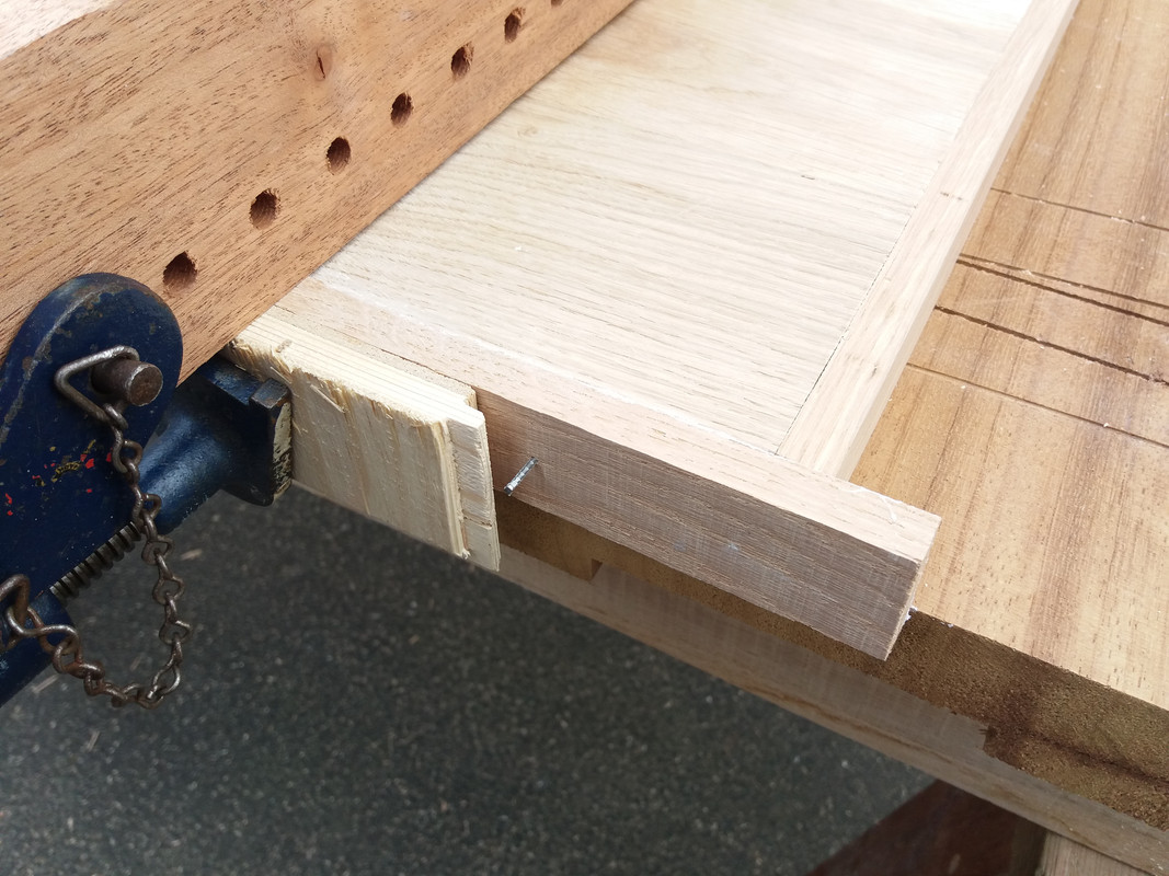

After planing it I cut it to size from the underside with a circular saw to stop it from spelching through to top surface, to be fair its a guiderail saw and the cuts are very clean but no harm in doing good practice to make it as good as possible.

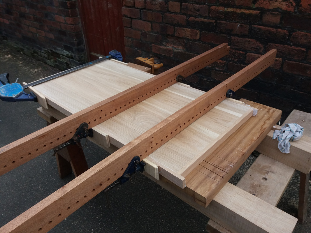

Then I've glued some slightly over width oak lipping on the ends, let it go off, routed the end lipping to the same size as the tabletop, cut the lipping ends and a little bit off the width down to size.
Lipped the sides the same way, its longer that it needs to be as well as extra width (the ply and boards add upto 32mm and I'm leaving the lipping at 35 mm til its glued on. Can rout it with a flushcut bearing guided cutter.
You can see where I've pinned the lipping on with three pins on each section, I used a brad nailgun shooting through a bit of wood with a slot cut in it, that leaves the pins sticking out of the lipping so I can pull it out with a pair of pincers when the glue goes off.
Here it is clamped up.
