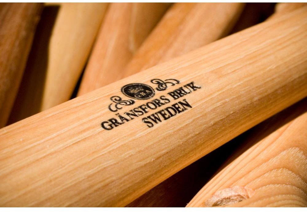

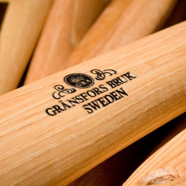

Well, I have been happy with the quality of all the Gransfors, Hultafors and Wetterlings that I have handled, certainly from a handle point of view. I have heard some people complain that the particular example they mail ordered wasn't as good as expected, but then I have also heard experienced people state that the grain orientation, which so irks some, isn't as important as is often suggested. So, a Google search for "Gransfors hickory hanldes" turns up a number, some of which sell handles for a number of premium and semi-premium brands. Other shops sell Smedberg handles, which can certainly be good.
