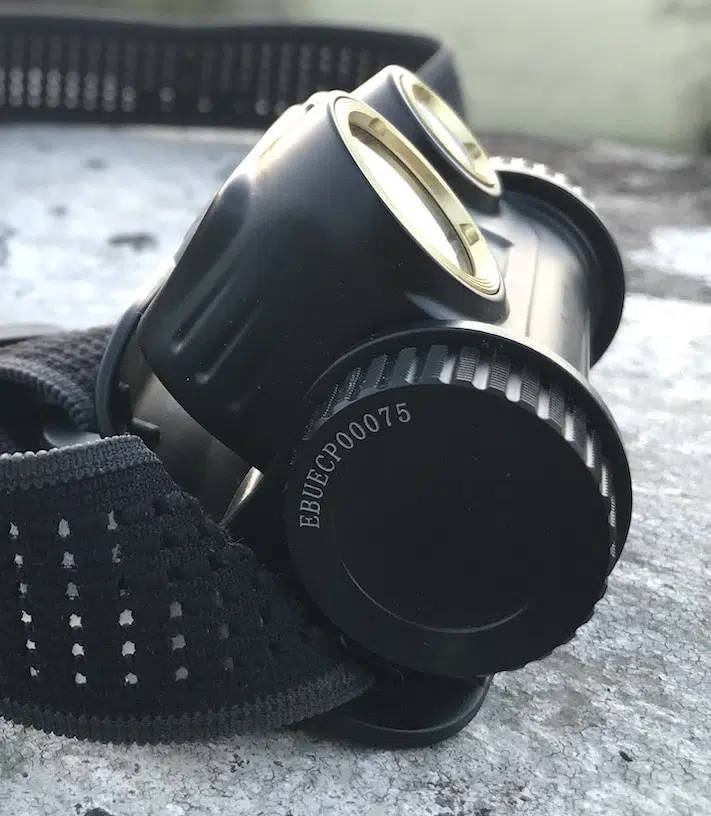

It’s comfortable and stable, the headband with the top strap works well and feels secure at all times thanks to a grippy rubberised strip, and the perforated design of the strap probably adds to its breathability, making it comfortable over more extended periods.
fenix shadowmaster head strap
It’s actually a silicone strip that grips and redirects sweat away from the eyes
The Shadowmaster feels solid and well made. The main body is magnesium, helping to reduce weight while being tough enough to take a battering.
The weight is reasonable at less than 100g, although this does jump to about 145g once the excellent 3500mAh 18650 battery is in place.

If anything, it would be nice to have an even lower output than the 8 lumens; that’s still quite bright for some circumstances. When the headlamp was tilted forward, it was easy to use with bare hands. Putting gloves on made it more challenging and cumbersome, a bit hit and miss at times.
My biggest gripe is that when the lamp isn’t tilted forward, the on/off/mode buttons are partially obscured, making it difficult to change modes; although this wasn’t often a consideration on occasion, it was.
I would have liked a mode button on the opposite end to the battery compartment screw cap as this would be easy to access, but I suspect that would have added more bulk.
