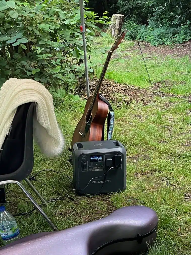

The AC180 delivered power consistently when put to the test. It easily powered a two-piece band, running multiple instruments, mics, amps, and speakers for an hour and a half with only a 23% capacity depletion. What was great was how clean the delivery was. We had run a mains-powered extension cord to the band, but it was causing some issues, so we dropped everything on the AC180, and it performed like a charm.
