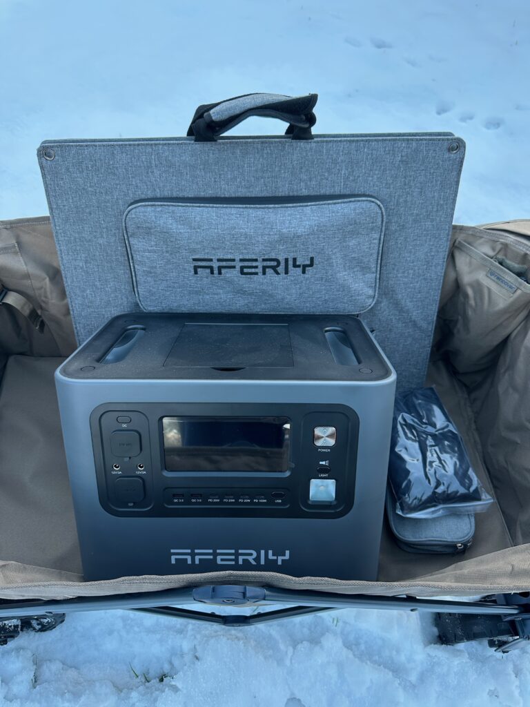

The P210 is built tough, but it is not waterproof. There is no IP rating, and while it has socket covers, these are mainly for keeping dust and debris out. The supplied cover sheds light rain, but they label it as a dust cover, so it should probably be treated as a dust cover rather than proper weather protection.

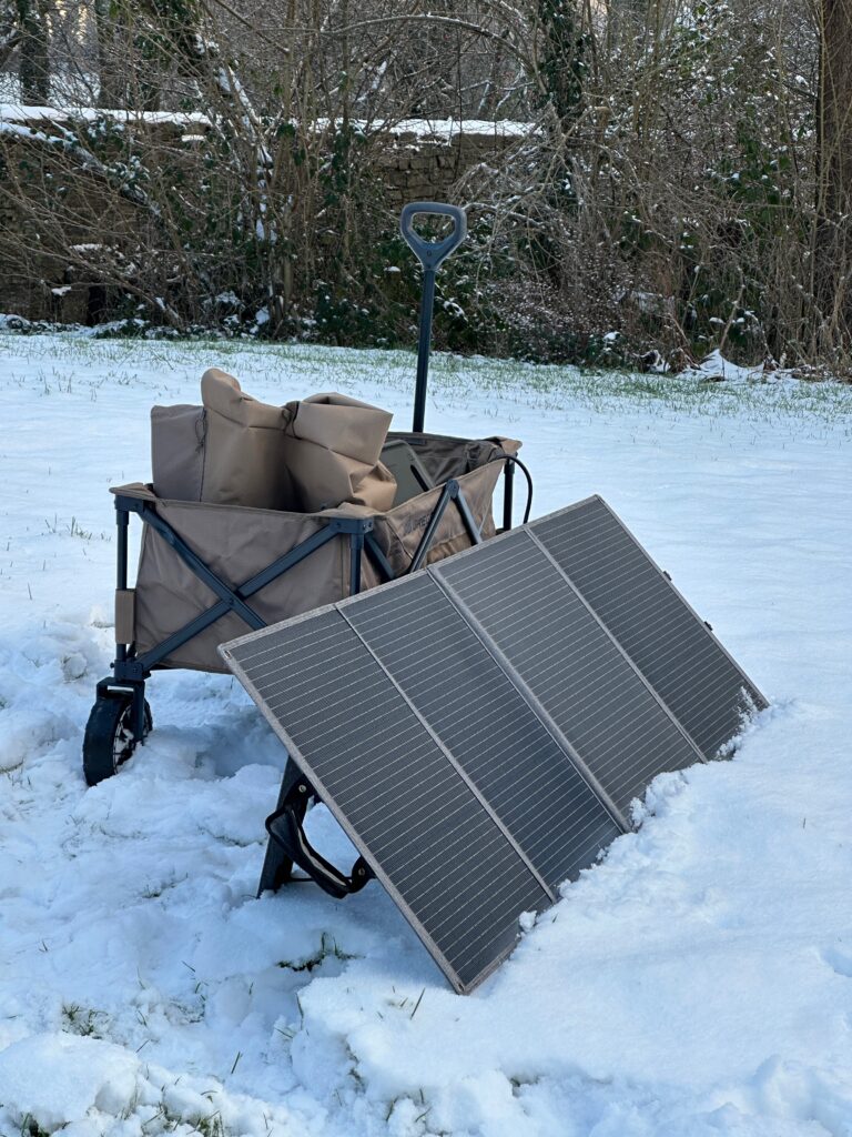

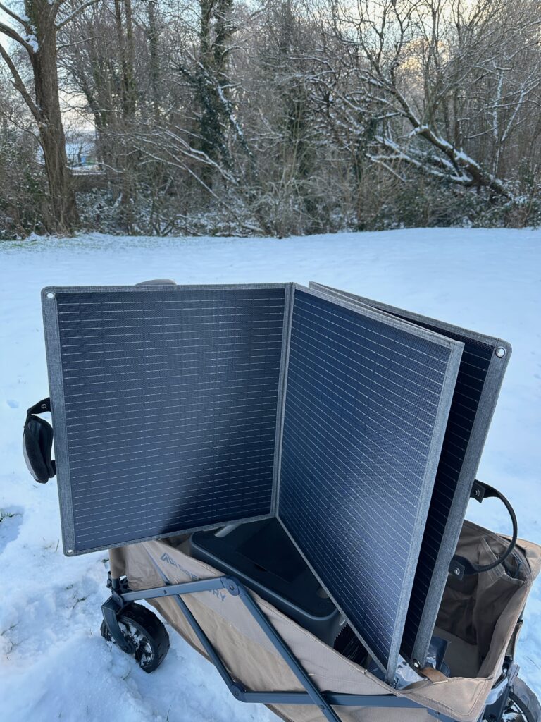

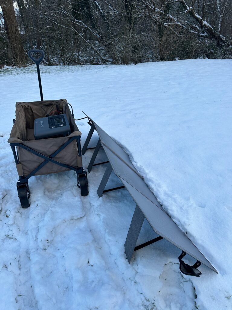

In real use, this simply means you plan around it. We ran the unit sitting in a Gregory Alpaca gear wagon with its waterproof cover on and positioned it next to the solar panel. This kept it dry while still allowing airflow and easy cable access.
The solar panels themselves are fine in the rain. The power station just needs a basic shelter, which is normal for most units of this size.

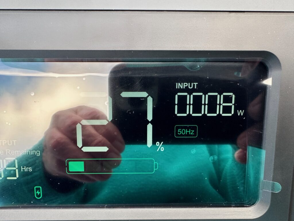

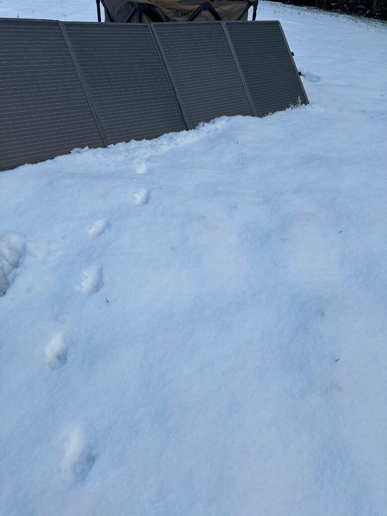

Using the supplied 200W solar panel, the highest input we recorded during one of our winter days was around 85 watts. This is entirely normal for low sun angles and heavy cloud cover.
While this will not rapidly recharge a 2kWh battery, it was more than enough to power phones, radios, and small electronics during daylight hours.
Aferiy supports up to 500W of solar input, which makes sense if you want faster charging. More panel area equals better performance, especially in winter. The solar panels aren’t cheap though, so 500w of panels would be a big investment.
In short, solar works, but slowly in the winter, and in the summer it would be much more effective. Treat it as a steady background supply rather than a fast charger.

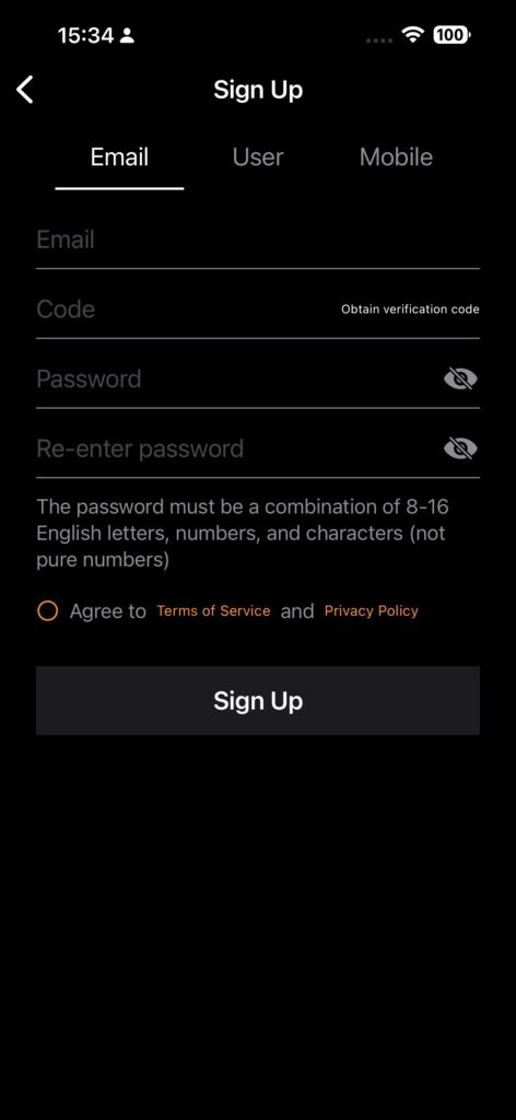

The app (the weak point)
We will be blunt. The mobile app is not good.
I gave up trying to use the app.
I went searching on the web and found that there were plenty of others who struggled with it as well. Pairing can be unreliable, the interface is clunky, and it offers little advantage over simply using the screen on the unit itself. For a power station this capable, the software feels unfinished.
Most users will ignore it entirely and operate the P210 directly, which works perfectly well. It’s a shame though as the unit is good, and having a good functioning app does add to the ease of use.
