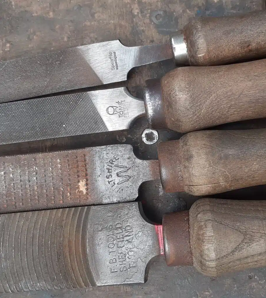

Most people will source their old files from car boot sales or other rusty tools in a forgotten toolbox or shed. If you can make out the maker’s name, then you will quickly learn good brands to choose for both stock material and actual use (though I would never buy a second-hand file because they are, at best, half dead to begin with). Some of the most common good files out there (in the UK) are Vallorbe, Grobet, Nicholson, Bacho, Oregon and Sandvik. I mostly buy Vallorbe files, so that is what I would be recycling.
Good files
Good files
