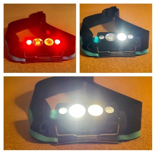

Like I have said, this torch is bright, so much so that it brings daylight to the darkest of places. The flood light throws out a large amount of light at a wide angle and the main beam goes further than you would need in normal use. With a total of 1400 lumens of both the main and flood lights on together, it will kill the battery in less than 2 hours, I’m not sure when this would be used and if you tone it down to the lowest of the four power settings on the main and three on the flood, you can get 60 hours from the both the main and flood light when used alone. The red light will give you 60 hours on low, and 120 on blinking. That’s more than enough for a long weekends use without the need for a recharge.

Red lights, flood and main beam
