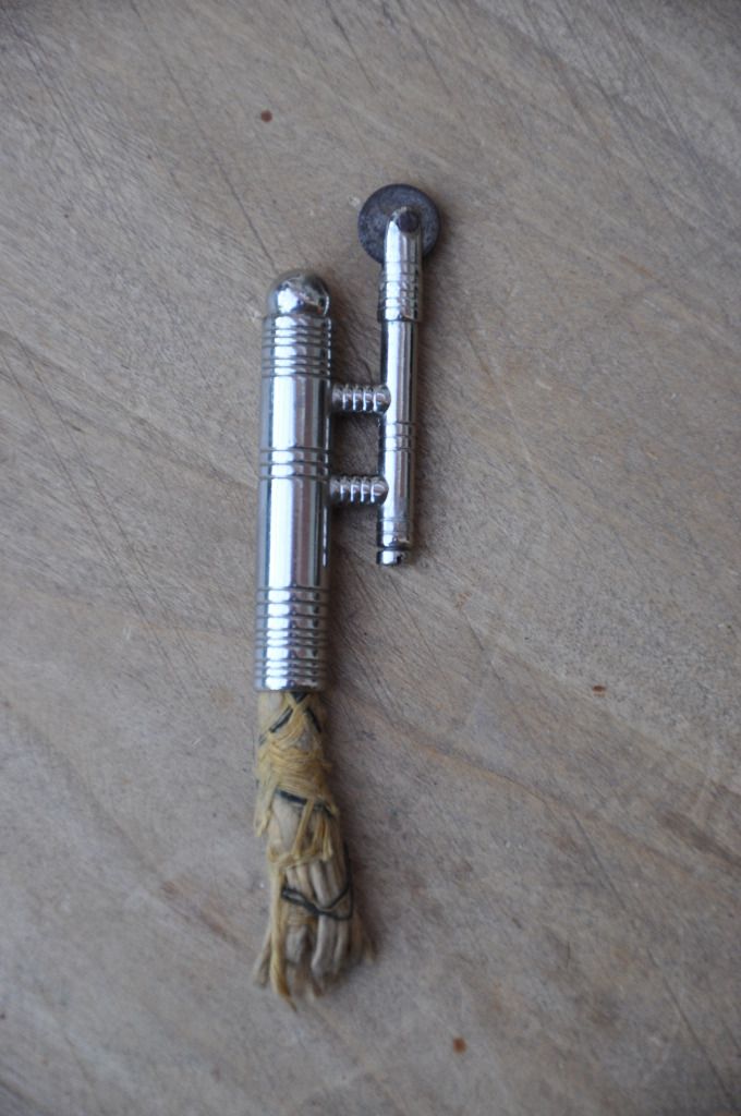

I mentioned on another thread i would post a tutorial for making a slow match from old shotgun shells. so here you go. The only thing i forgot to mention was that you need to trim the crimped end of the red shell too.

2 make the cord just dissolve 2 tablespoons of KNO3 in 2 litres of warm water in a well sealed container (butty box or 2l pop bottle) and soak overnight. lift out and drain well then dry flat. you rope should be supple, if its crusty and shows signs of crystals you've over done the KNO3
Once the rope has been burned once it will readily take a spark from a ferro rod, flint and steel or solar lens. For anyone coming to the RC Torm meet at rough close i will bring some along as gizzits
