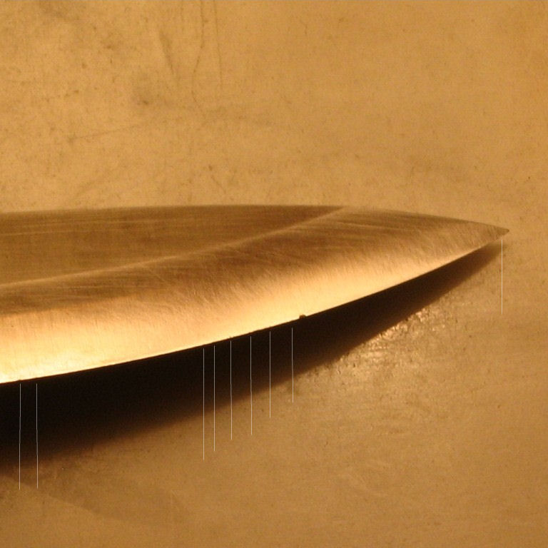

Hey guys,
I've nicked the edge of one of my knives. This is the first time I've had to take it to sharpen, so far I've been able to keep a keen edge just with stropping. The nick is less than a 1mm deep, and the blade is CPM3V & convexed. Still paper shaving sharp but you can feel it snag, and it bugs me when I see the nick :yikes:
Can anyone suggest what grade of sandpaper to start off from? I have 400 up to 2000.

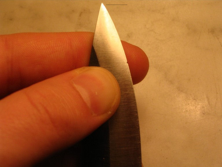

It's really quite small. I've taken a few pics hopefully you see what I mean. My concern to sharpen out the nick I'll have to dull the knife and work it back to sharp which is something i've never had to do before with a convex blade.

From the pictures it looks like you have a small nick a couple of mm in from the tip, and some additional micro-nicks just behind the main nick you highlighted as the problem (as you see it).
All of this can easily be rectified using simple materials but if the knife means anything to you at all (either personal or monetary value) then have someone show you rather than setting to it with good intentions alone.
If you don't already know how to do it you will only make more work for yourself or someone else later on.
CPM3V is very abrasion resistant and the majority of people often end up taking too much metal off at the tip, which will produce a slightly rounded tip instead of the nice point it currently is.
In short, this is no big deal if you already know how its done. If you don't, find out first or have someone do it for you and learn while the knife is away so you can do it yourself next time.
A magnifying glass or loupe would work wonders in establishing the full extent of the damage.

Many thanks. Not concerned with the micro nicks, I can deal with those :) But with the big one as Robin says means I'll have to go in far. I bought the knife with the intention of improving my own skills so I definately want to tackle this myself. If I make a mess I can always send it off I suppose.
I'm not sure exactly what caused it, it happened somewhere over the last weekend. I think the main nick was made whilst breaking up a stump for fatwood, and the smaller marks from grit perhaps?
