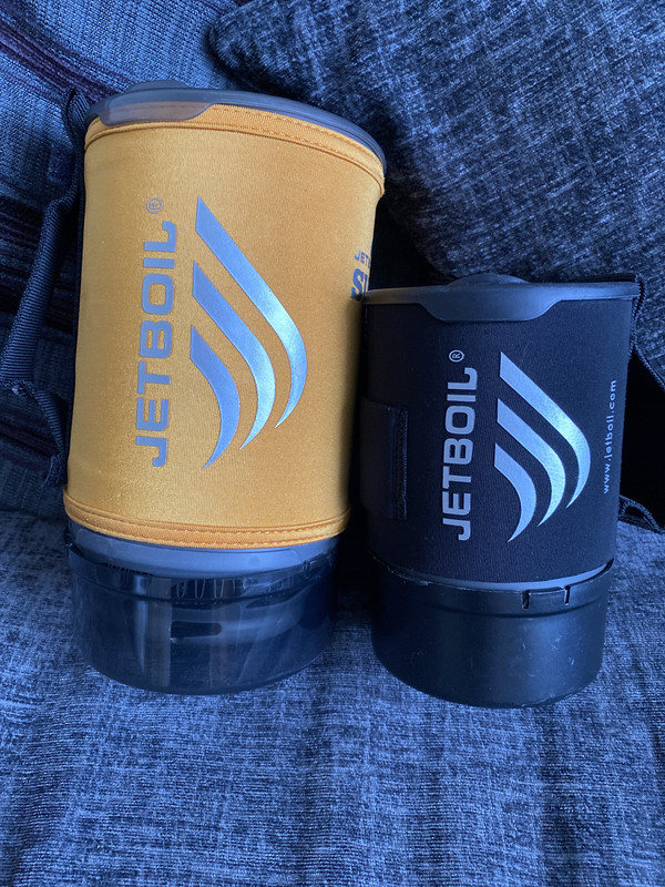

I have a Zip and a Sumo. It’s handy as my whole packed up Zip fits perfectly inside the Sumo giving me two carrying options.
My Zip burner also fits the Sumo cup perfectly. My Zip is also regulated, I seem to remember later ones were ?

Ahh so hopefully the burner I have should fit all the cups in their range, Zip, Micro, Flash & Sumo. It would make sense as from pictures of each the notches seem to be in the same place and even on the larger diameter MiniMo pot the bottom of it tapers considerably to accommodate the burner.
Interesting that Jetboil don’t Market this point.....I guess they want people buying the whole sets rather than one burner and then purchasing multiple cup options.

Sorry should have explained better. One complete Zip system that I use on its own. If needed I drop that straight into a Sumo cup. Great on their own, or combined.
