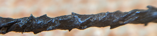

Ascobis
Nov 3, 2017
146
77
Wisconsin, USA
Scaled down to 640 px wide from 4,000. It's been through a few dips in de-rust solution over the decades. Note the barbs. This is three plies of barbed ribbon twisted together. Current Gigli/dehorning saws are various gauges of round wire woven together. Sharp tooth >> round bump.
