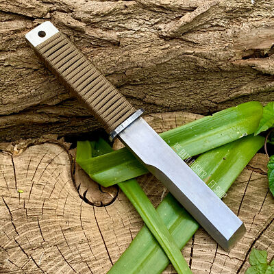

What are peoples thought regarding if a file would be suitable for converting into one of these..
Obviously it would be too brittle unless heat treated (I'm a maintenance engineer, so old files aren't in short supply!)
Or would some tool steel be more suitable (loads of steel stock on ebay)
Basically, want one, but don't 'need' one and dont want to pay a lot for one!!!! haha

How does that qualify as a 'pry bar'? It looks more like a combination of a cutting edge and a chisel to me but maybe my experience of 'Military Grade' pry bars is limited :)

Looks like an EOD Robotics Breacher Bar with guard. Originally they were made in 1045, now CountyComm sells them made from titanium.

1045 is probably the cheapest even half way decent material one could make a sharpened pry bar. If I wanted a real one I would make it from a mid alloy "normal" (0.6-0.8) carbon steel, price difference not much but a fair increase in strength.
