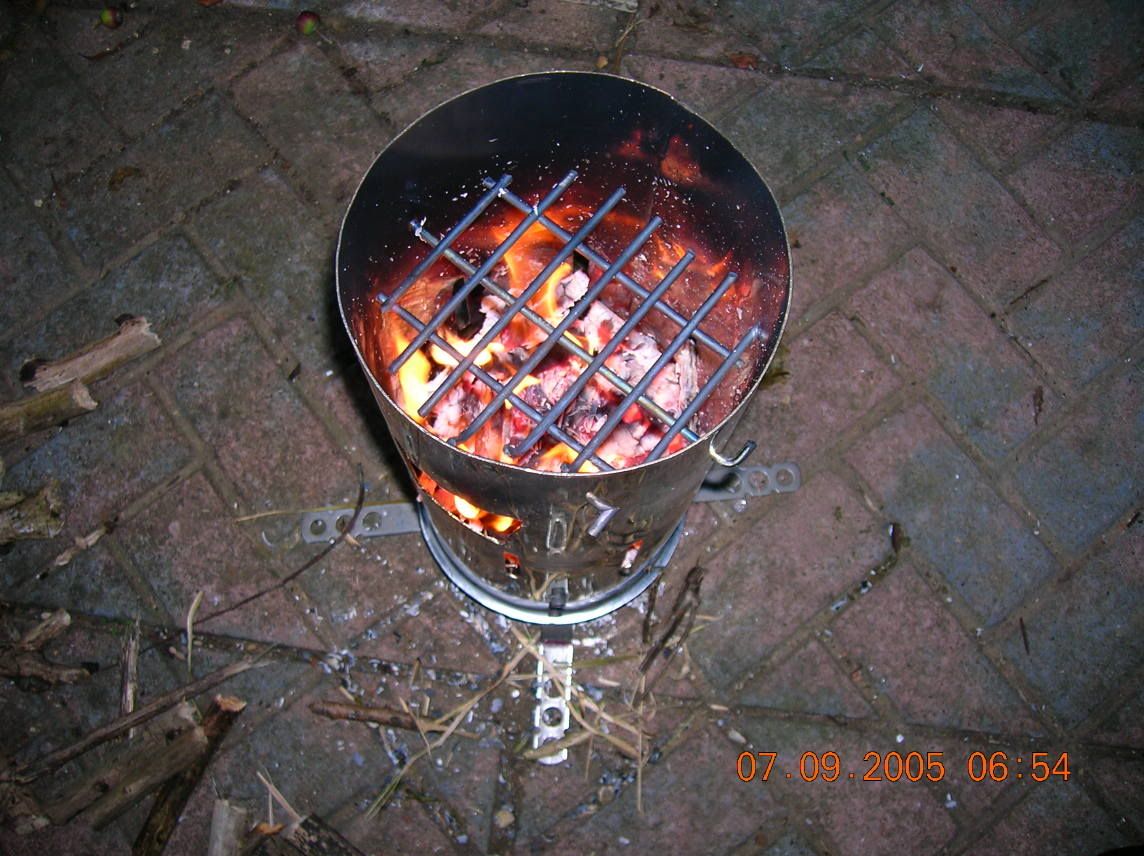

Nice job mate - the only thing to persuade my wife to sit outdoors as the temperatures begin to fall.......

Very nice piece of work that.:cool: :D What holds the fire up? Do you know what the stainless tube was from originally looks like flue from a boiler? had alook at making one but out of aluminium not stainless hummmmm time to rethink

James, Inside at the lower end of the stainless tube is a wire mesh tray(old stainless steel grill ) which rests on and is bolted to in two places to the four suporting leg plates. (the flat plate legs are turned over at right angles inside the tube and provide a resting place for the mesh tray.)This fuel/wood support grill is at a level the same as the lower end of the circumferencial vent slots. Yes your right I guess it was an old boiler flue.Cheers for all the positive feedback guys. Ivan :)

Nice one Ivan - yup one of those things ive had in mind for a bit too. A cross between a kelly kettle and a trangia. Sounds like it works really well, and a nice finish to it. I lok forward to seeing it at a meetup.

Nice work hyfan. Could you give us a rough idea of the dimensions?

The main tube is about 12 inches high. The four legs hold the lower rim of the tube about 1and half inches from ground. about 3inches up the tube is a mesh platform to place the wood. Cicumferential verticle slots to let in oxygen /air are positioned around the tube at the same level where the fire burns. The fire area accomodates about 3 and half to 4 inches of height in the tube. Just above fire area is a small grill to rest the billy on. Or a pan can sit directly on the top.
The dimensions that I used were to suit the scrap tube that I got from the scrap yard. The tube I used was stainless (which admitedly is a bit of an overkill as any sheet tube material will work) I would suggest if you find your local scrap metal merchants have a look or ask first if they have a stainless skip. Where you may be lucky enough to find an old stainless flue like I used. Be warned it is a real pain to work stainless and you will need to use a small angle grinder with a metal cutting disk fitted to make any cuts.
Hope this helps
I would suggest you experiment with dimensions. Best to just workout the size of fire you require then space the fire support and billy grill levels accordingly.
Good luck
