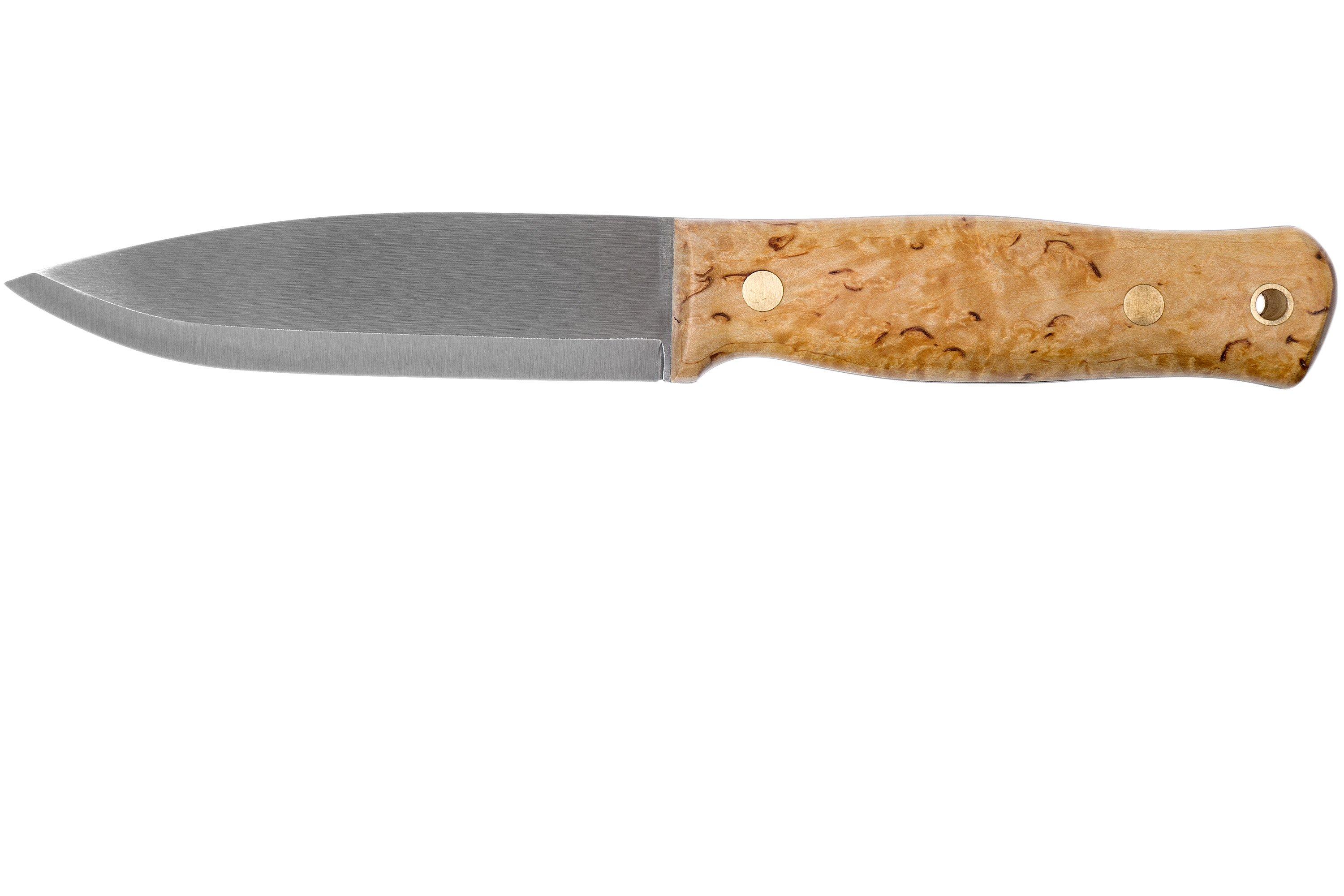

If you pay attention you will find that everybody said, that the classical woodhandle Mora knives weren't far away from being the optimal survival knives if they would have a thicker blade and full tang construction. You actually find videos where you see Mors Kochanski using them.
You can find at YouTube videos where Paul Kirtley and Dave Canterbury recommend the Morakniv Garberg.
It's cheap and fulfills the specifications that peple were asking for.
Although it's a hidden tang it's also a full tang.
The Nylon handle is unbreakable.
It nearly fits the specifications the Swedish air force did ask for when they ordered the Fällkniven F1. The blade is just a bit thinner but made of a very good steel.
That's in my opinion exactly the knife all experts were asking for over decades.
And what Brisa and Caström mainly offer fulfills these specifications as well.

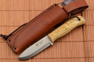

Oddly enough, this evening I've been looking through Joker's knife range for a woodlore copy. The Ember and Nordico are in the ballpark but not quite as acute.
