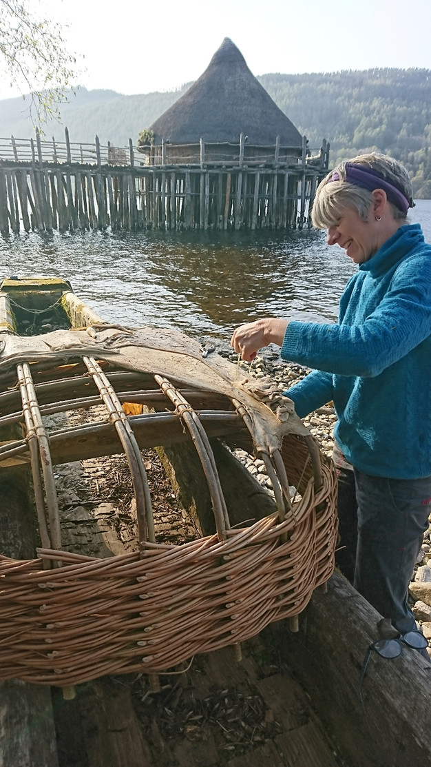

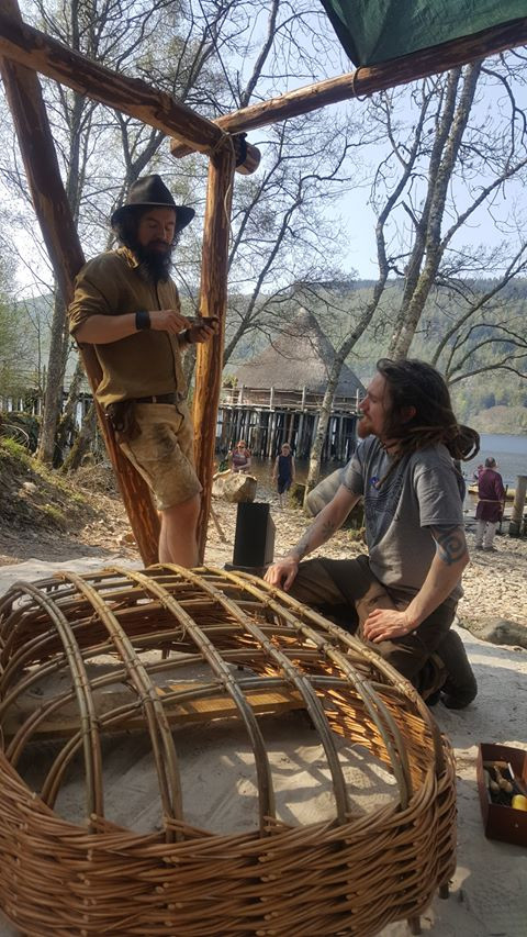

And so on to the coracles. We didnt get a chance to snap any images of making the frames, but they were woven from local Willow under Janes expert eye with solid hardwood plank seats. We wanted to experiment with different methods and styles so the two coracle frames were different regional types, one large and round which was more of a two person vessel, and a smaller oblong style. The lashings on the frames were done with modern cordage as we didnt have the rawhide ready to hand, but once they were finished we were able to take them down to where we had the rawhide and relash them with rawhide cut from a deerskin. Once this dried it tightened up creating incredibly strong lashings.

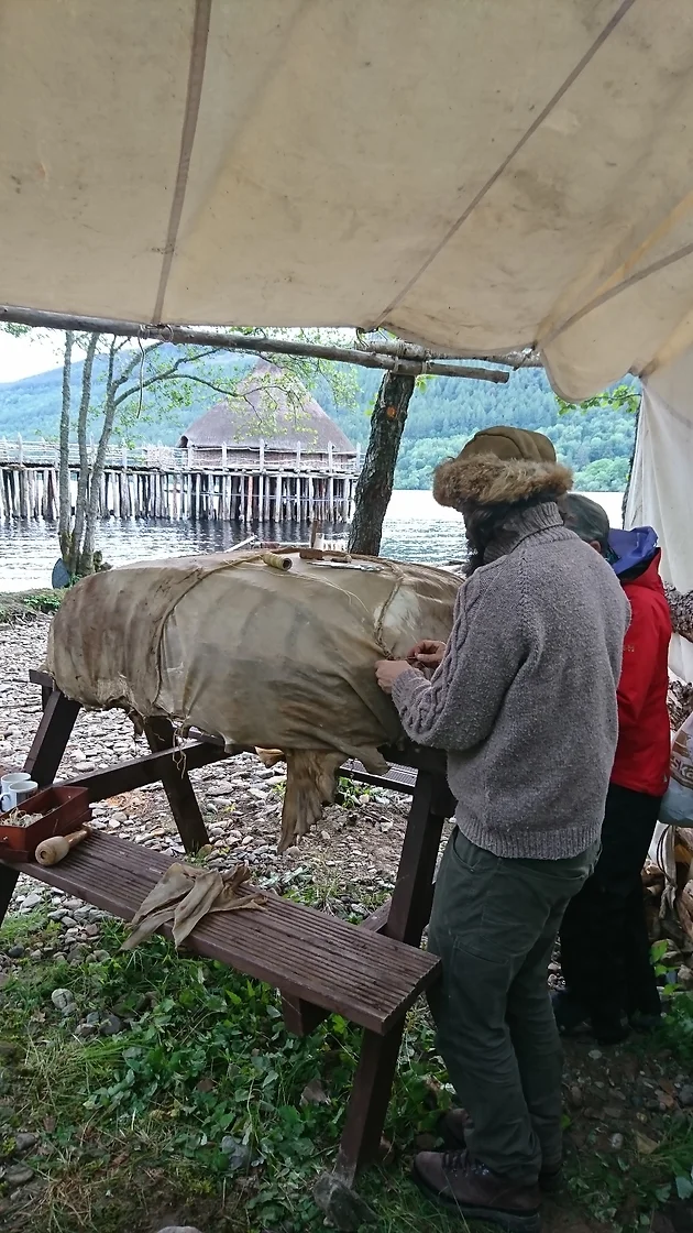

For the large frame we used a cowskin, large enough to cover it with one whole skin. This was especially hard graft to tension the skin (over 10mm thick) over the frame and lash it in place with rawhide.
SMLXL
The cowskin was lashed to the frame using rawhide strips cut from a deerskin, the same as the frame lashings.

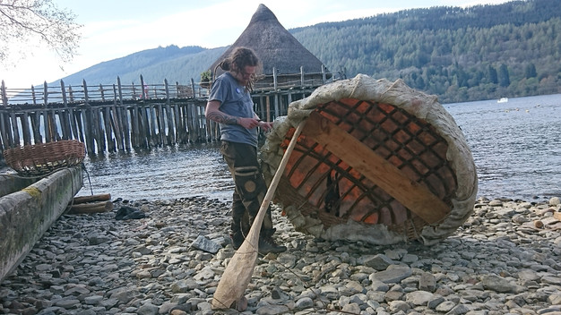

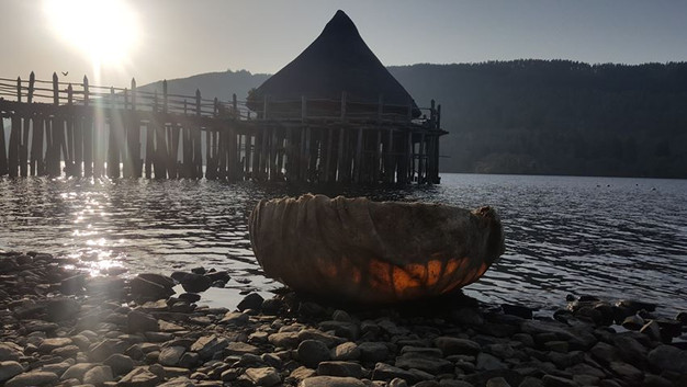

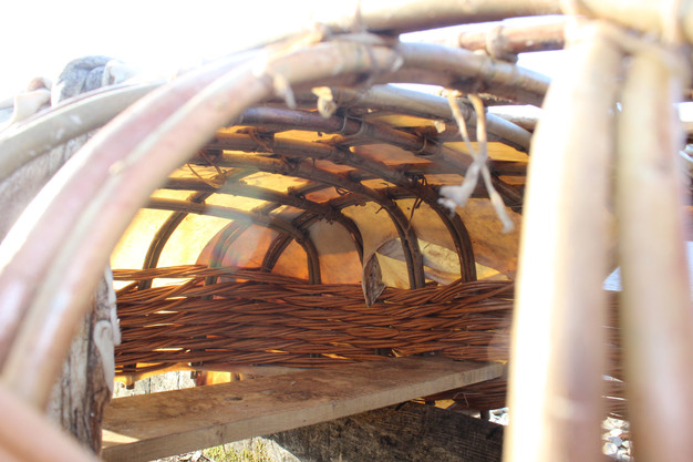

Propping up the coracle when finished allows us to trim any excess flesh left on the hide, dry it out in the sun, and also by looking at how much light comes through we can see any potential weak spots.

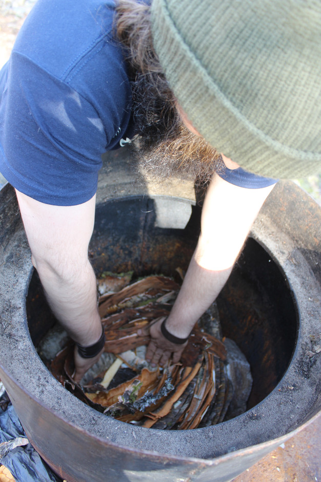

Birch bark being packed into the burner
SMLXL
SMLXL
We compressed the bark as much as we could and sealed the burner airtight with sand. with an even heat around the drum, the bark needs to heat without igniting so that the oils leach out into the bottom pipe. Once the oil is collected it can be reduced down into tar.

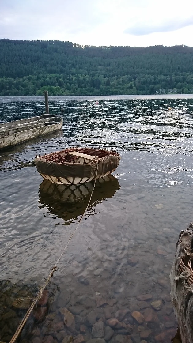

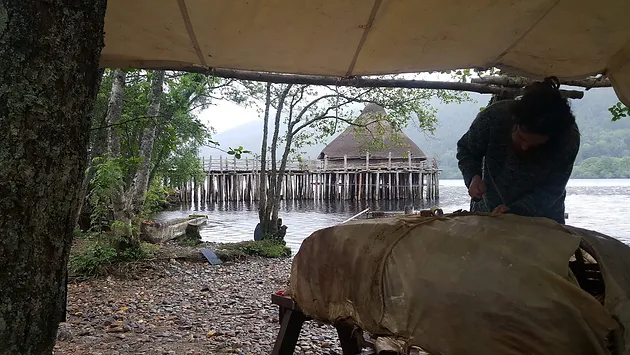

It's now June and we have been back to the Crannog to finish off the second coracle we were making with deerskins instead of cowhide. We resoaked the skins overnight, then set back to getting them stitched together over the frame.
Meanwhile Jason takes the previously finished coracle out for a paddle!
Dreadhead
Voila! another finished coracle. It floated straight away, though there was some leakage through the seams as they need tarred.
our two finished coracles.
The coracle being hung up to dry so that we can tar the seams later.
