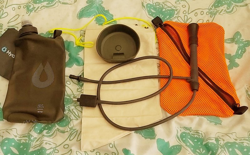

Here´s my waterfiltration system.
Left to right:
Hydrapak with BeFree filter.
Millbank filter.
Foldable cup to fill Millbank with.
Water pump for occasions when water is hard to reach to.
Orange pack pouch for the stuff.
