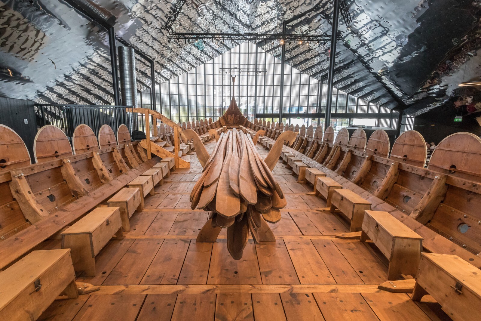

Not seen the Myklebust Ship myself, but that looks like a good reconstruction.
I suspect the chests would have been more varied in construction, as I think they were probably personal possessions rather than ships fittings but people argue over that one all the time.
The "Room" was the space between the ribs fore and aft and the chests take up about half the space which was allotted to each man so they look about the right size to me.

Wonderful ship, not seen that one yet!
To my practical eyes, Waylands chest lid looks nicer to sit on.
My guess is that the chests on the ship would be rotated 90 degrees when used to sit on and row.
Amart from the rear end friendlier curved top ( maybe with a cushioning sheeps hide ) i would think the feet / stand should be wider to prevent tipping when force is applied when on the oar, and in bad seas.
My backside would prefer Waylands cask/ stool.

Yes, it provides additional freeboard and keep the sailors a bit drier.
The chests on that ship are in sailing position. They would be turned 90 degrees for rowing.
