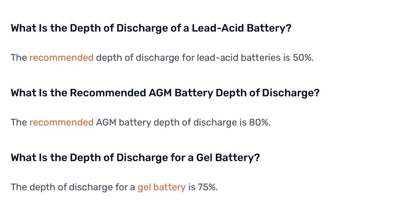

A 120ah agm will only really give you 60a.
There not designed to be depleted to less than 50%, and that's a push for them. In my experience likely to get 40-50ah from them and lucky for a year of heavy use (200 cycles/2 year warranty).
Lipo4 will allow you to use upto 95% of the battery capacity and many more cycles (3k+)
Go for a 2000w inverter, not much of a difference in price but allows you to use more appliances at a push.
I know its not the cheapest, but a 100ah lipo4 will honestly serve you better, or if funds allow I would push for a 170ah lipo4 minimum.
