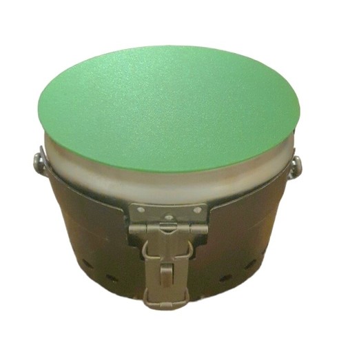

I’ve just received a cutting board from an eBay seller made to fit the Swedish mess tin.
The one I received fits inside the pot lid and will sit on the “shoulder” of it. It will go in the main pot at a slight angle.
It’s pretty light, slightly flexible and 2-3mm thick.
You could do it yourself but I quite like knick-knack’s that peope made.
It’s certainly up to the job of food preperation or as a light work mat. Just something that adds to the utility of the mess kit.
Is that not where the mug/kuksa is supposed to sit?

I don’t know how it should go but I fit it like this:
In the main tin SVEA burner & Tatonka simmer ring go in ziplock bag.
Kupilka inside Kuksa on top of them plus cleaning cloth. Still space for other bits.
A box of cooking matches, mini bic lighter and folded trivet go inside the lid with the cutting board covering them.
Then I turn the lid over and fit on. There’s still room for folding cutlery. I keep the fuel separately anyway. I empty the burner before packing too.
Doesn’t rattle like this and I could pad it with a bandana if that was a problem.
