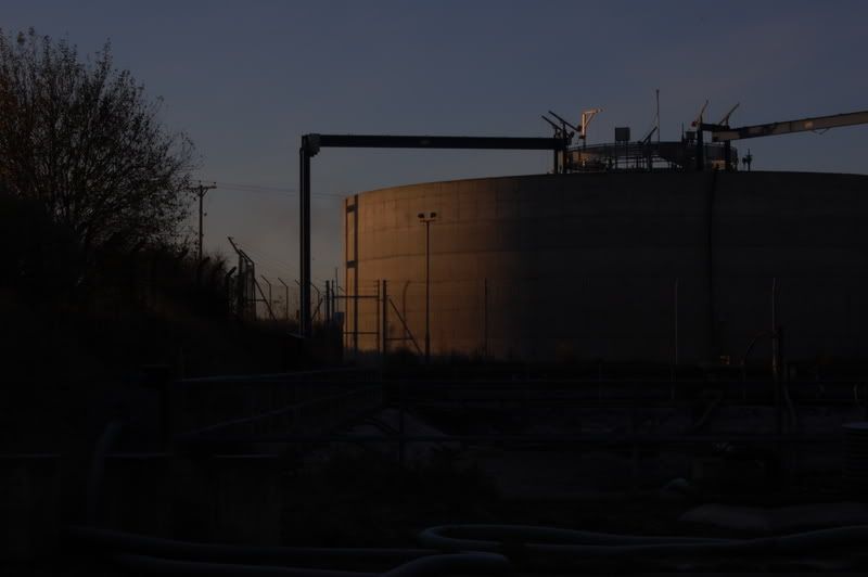

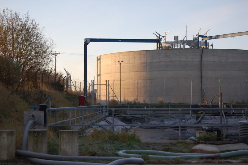

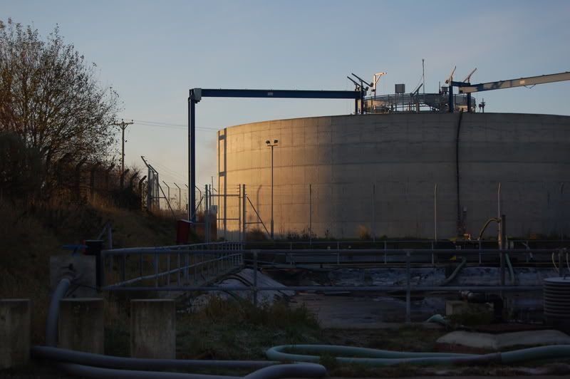

So we have
This was taken with the "Auto" setting
ISO 400
S 1/400
App F5.6
ISO 200
S 1/60
App F36
ISO 200
S 1/160
App F6.3
ISO 200
S 1/500
App F5.6
ISO 200
S 1/16
App F36
