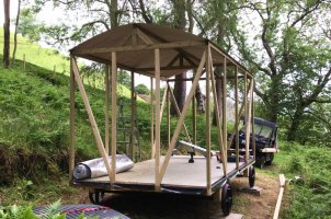

Quick update:
The studding has gone up, the base floor is in with a membrane under it (the floor will be insulated and planked once the inside is finished), the ridge is in and the 'ceiling' installed. Since this photo the insulation layer has gone over the whole thing ready for me to put the first few planks on each side before the corrugated roof goes on this Saturday.
So far, about 25 hours on my own. Thank heavens for battery powered tools :)
Note to self: next time, clear a much bigger space to work around and MAKE IT FLAT!
