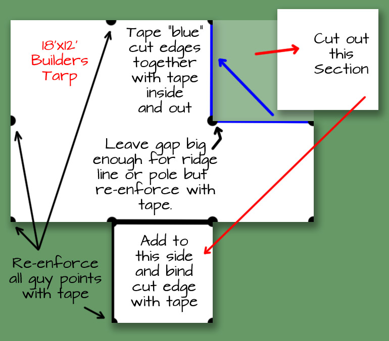

The background was set then for me starting to think about ways to improve this basic set up and after experimenting with some scissors, a sheet of paper and a roll of Sellotape I was ready to make this extended version of my Winter shelter that I tried out for the first time at a small meet in the Peak District.
![Wayland-Shed-Cutting.jpg](http://www.ravenlore.co.uk/assets/images/Wayland-Shed-Cutting.jpg)
The construction is made from an 18'x12' poly tarp which is a fairly standard size and requires a 6'x6' section to be cut from one corner. This section is then re-attached onto another edge to form an additional awning that can be folded down to cover the front opening if necessary, much like a traditional Baker tent.
The raw cut edges where the section was removed are taped together, leaving a small hole for a ridge line or pole at the top. This forms a much stronger version of the walled annex that I found so useful by adding a second sheet in snow conditions.
