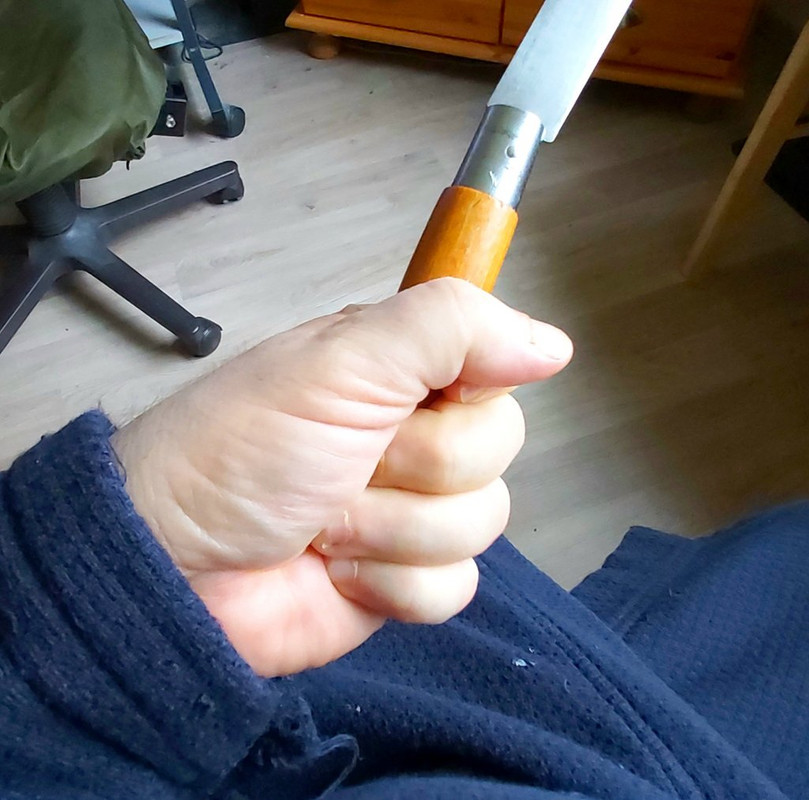

I don't have a picture of that hold with a leuku, but I have another photo that may be close. Is this the sort of hold you mean?

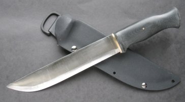

All the talk about guards reminds me of some of the first knives I made, based upon the designs of Ed Fowler. This was leuku size...PICT1079.JPG
Yes, that's it. Three fingers hold the handle and little finger curls over the pommel and prevents the hand from sliding forward. After some time it is a fairly easy holding position and it allows a very natural whacking motion using the wrist.

@C_Claycomb
That's a very nice piece (leuku) !
About your knife with guard, what do you think about ricassos ? It is something I totally can't stand if they are larger than 1cm.
Thanks.
I don't like how large ricassos affect function for a general outdoors and wood working knife. I still think they look good in some cases, but I tend not to have large ones any more. My experience has been that larger ones are not detrimental on a knife that is used solely for game prep (gutting, skinning and butchery).
The Ed Fowler design philosophy came from ranch work and big game hunting and butchery. The big guard, thick blade and 19 - 25mm ricasso all worked together to allow very secure hold of the knife even if your hand was covered in bear fat. While he carried a knife daily and worked with one a lot more than most folk who enjoy "bushcraft", he didn't do much wood carving, nor light weight back pack camping.
