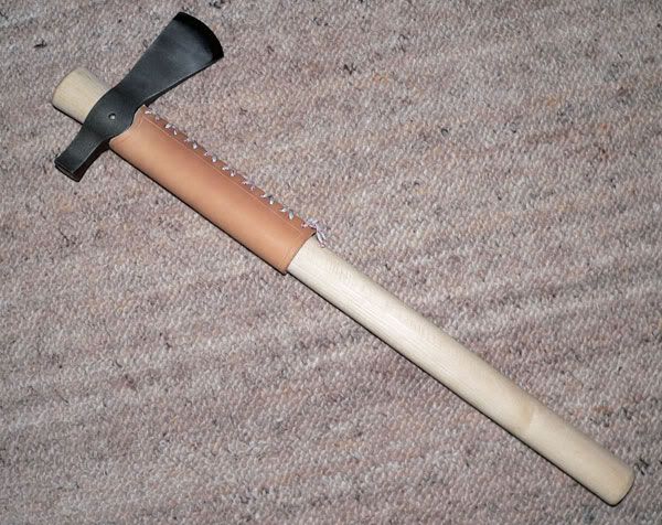

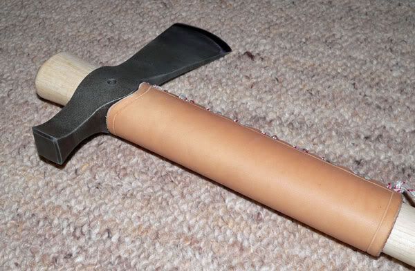

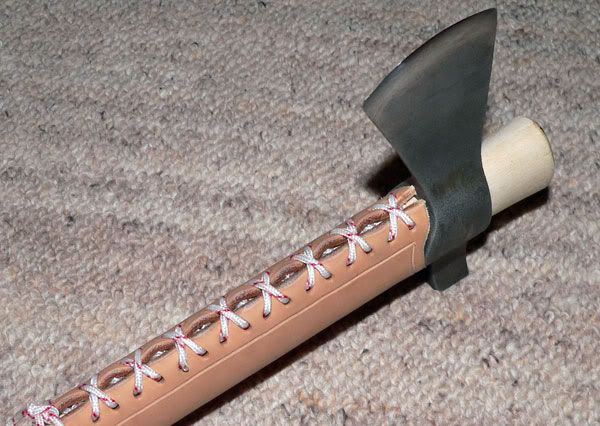

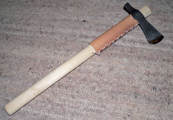

Yeah, the acid oxidises the surface of the steel and forms a thin barrier to further oxidation by creating a superficial layer of black iron oxide - it's a similar process to parkerizing or the bluing or browning of gun barrels. It's not a very effective barrier and needs oil to seal it, but it does stop that instant rusting you get on bare metal as soon as it's exposed to an electrolyte. You just dip the steel in an acid solution (I used ferric chloride but some use strong coffee, vinegar or mustard) untill it gets a grey-black layer, rinse with clean water, dry it and oil it and that's it. You can buy commercial treatments that do a better job and I think the pretty axe posted by Highbinder above, has been treated with plum brown barrel finish.Also, could you explain the etching for rust protection please?
