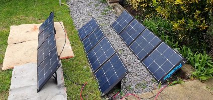

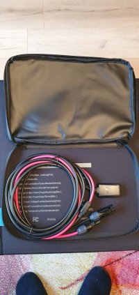

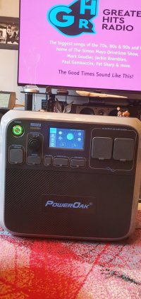

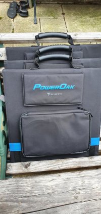

So long term I’m thinking of building a Camper Van with said Solar Panels and bits.
I now have a 2000w Power Station Bank that can be charged in 5 different formats,
Mains-Solar-Car Charger etc, and power up to 12 items which will be used in the Van
I have 3x120w and can charge the Power Bank from empty in around 4hrs in ideal conditions.
So what have I learnt using the panels, quite a lot if you want the best performance. Being portable and easily moved is essential. The best way I found doing that is so simple, rest a can of freshly drunk beer can :cool: on the panels. Look at the shadow of the can, which ever way its leaning, you tilt to have no shadow.
No Shadow equals the best performance in those conditions. However be aware that you want your panels in clean air to the sun, the slightest shadow on even the smallest part of the panels can adversely effect the efficiency.
So although I have 3 panels they can be used as 1,2 or 3,, each panel has the complete wiring for any combination.VideoCapture_20220407-224237.jpg20220306_134714.jpg20220305_152247.jpg20220305_153838.jpg
